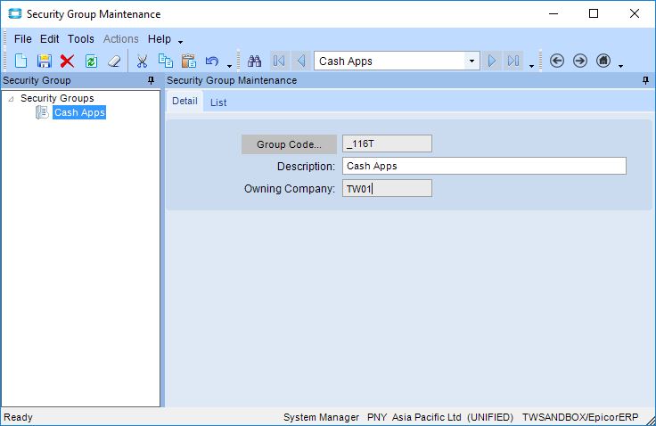

We converted from E9 to E10 a year ago, and all the inherent Security Groups were flagged as All-Companies (or at least, that’s how they converted over). We’ve since added a second company and now, any new Security Groups created automatically are assigned to the current company as the Owning Company field defaults to the current company. That’s fine, as that’s what we want to happen. However, these new Security Groups do not appear anywhere and cannot be chosen. Is there a system setting that needs to be flagged?
New Security Group “_116T” entered in the Maintenance UI.
The new Security Group does not appear in the search screen.
The new Security Group does not appear as a selection option in Menu Maintenance.
The new Security Group does not appear as a selection option in User Maintenance even though the user is authorized for the specific company.

Okay, I made sure the description is a unique name. The code already is unique. Signed out and back in, still not visible in the search or the two maintenance screens. I can access the record by the security code in Security Group Maintenance to modify it.
I take that back. The Code is indeed showing now that the description is different. Thanks for the help.
