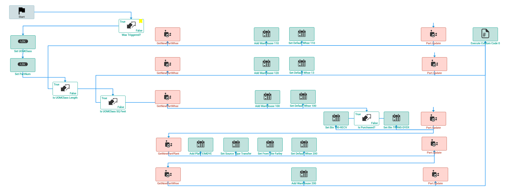

A while back @gpayne posted a BPM to automate the addition of PartPlant and PartWhse records on new part creation. The intent of this BPM is that if you add a new part, it gets certain plant and warehouse default according to its UOMClassID. I modified it into a monster, and now that monster haunts me.
Here is a picture of it.
See the red? yeah… it turns red for no reason sometimes. This is from the DB where this BPM is functional. This BPM was used in production for months, and nothing changed. Then, two days ago, we started receiving an error. Every time we add a new part, with UOMClassID COUNT (bottom-most flowchart branch) the first part.update fails. It didn’t used to fail. Nothing changed.
Re-importing the BPM from a stored copy fixes the issue. There is no difference between the imported BPM and the live one.
Does anyone know why this is happening? Why do those GetNew and Update methods turn red periodically? Why does it wear down, decay, stop working every few months? The last time it broke down, the whole BPM became read only, and it wouldn’t let me modify it. The solution last time was to delete and re-import it.

What is missing when you click on one of the red widgets? I have seen this before and don’t have a solution.
Absolutely nothing. If you click a red widget, open up the configuration slide out, DO NOTHING, then hit save, it turns green. Then, after a period of time, it will be red again…

Well thats the thing, I know which widget it failing this time, its the last Part.Update widget on the bottom right. it gives me an error “A Primary Warehouse is mandatory and cannot be directly removed.“
So I started looking into it and I think I’ve got a handle on it now, but why would it have changed? why do the widgets become red? is it going to fail again?
It worked for months until this week…

Sounds like a bug in the designer, and you have a logic fail at the same time to me.
Yeah, the kinetic designer is definitely not an ally here. But seeing as how this BPM is only fired on adding a new part, and only touches the PartPlant and PartWhse tables, and those haven’t changed. If I had a logic error, it should have shown itself last August when I stole this BPM from Greg
I just have a hard time believing the bpm is breaking without being on an upgrade.

Shes still red. I can open, save and close them to be green- which I’ve done. I am sure they will appear red again one day…

We’re on Prem. I got my BPM working again by adding a few extra fields. still have plenty of red widgets, so I can confirm that them being red isn’t whats causing or breaking the code… What puzzles me is that it just… Broke. Seemingly for no reason.
I wrote software to backup all our BPMs and custom code years ago, but I think I might update it to copy the dump sources file, that way I can diffcheck on that as well. I don’t know what else there is to do. Hopefully it doesn’t break again.
