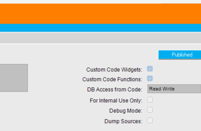

There is a checkbox Dump Sources straight on the EFX or BPM, which is supposed to be Cloud friendly, no need to touch web.config host.config - Also this was added in more recent times Maybe late 10.2.600+
The checkbox does nothing unless it’s enabled in the web config host.config.
It also by default goes to a place where cloud has no access.
It does for me, I check that and trigger a Save on EFX or BPM atleast, it writes it when having default web.config but I am on-prem.
Correction, not web.config, host.config.
