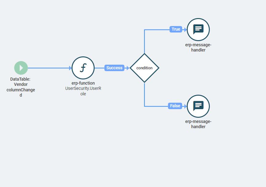

Hey All,
i have this condition
It’s firing a function which returns
  "hasPurchase": "True",
  "hasFinance": "True"
In the condition I have set expression: "{actionResult.hasPurchase}" === "true" but the true and false don’t seem to work…
actionResult.hasPurchase changes from false to true if I add/remove the usergroup but the message just fires the false value… LOL
but I have the correct user group. Thats why it says at the start true
What am I doing wrong???

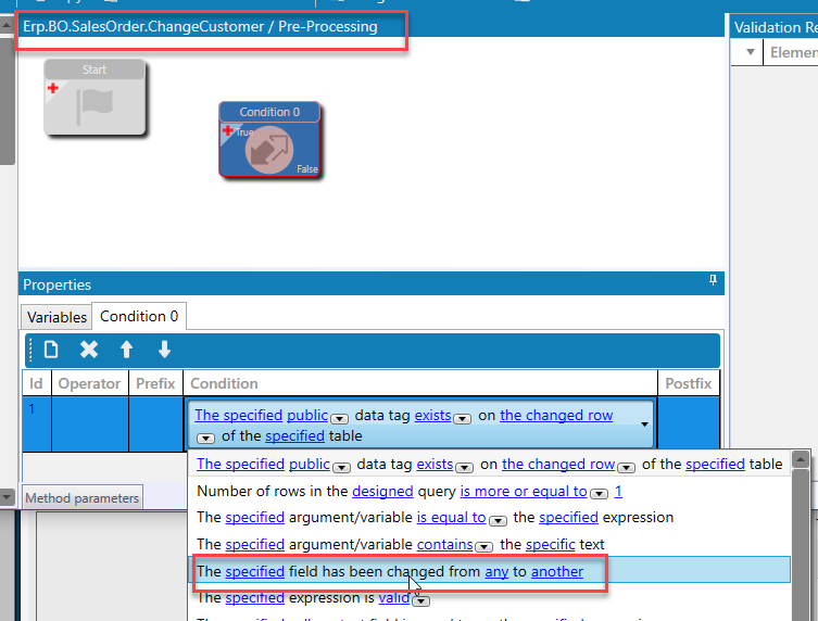

We’re not on Kinetic yet, it’s a big leap from how Classic is customized. Are you sure you got the syntax correct? Could this be done as a Pre-process BPM on the save method? That’s where I put checking user groups as it’s a server function not a UI function.
How would you check if the column has been changed? I didnt find the column changed from any to other… in conditions

have you tried {actionResult.hasPurchase} == true
Pre-Process condition block has it.

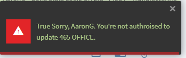

Let’s all just take some time to appreciate this error message.
