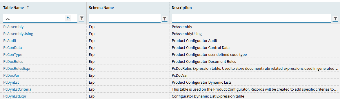

Curiously, I don’t see any recent entries in the PcStruct table (maybe that’s the issue). Also, no recent entries in PcValueSet.
Do you know of a list/map of the configurator-related tables? The descriptions in Data Dictonary are hit-and-miss. For now, I’ll grep through anything that does have “configurator” in the description.
I thought table with pc as the prefix were configurator related… @kve?
Thanks, yes, that looks reasonable → Capital P, lowercase c tables.
There’s quite a few of them, this might take a minute.
