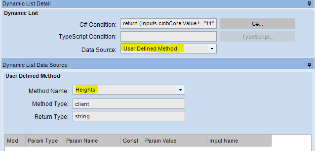

Below is an example of how I do it. I want the dropdown to be populated with a list of numbers at 75mm increments. The highest number is dependant on the product dimensions being used by the method called Heights;

I then call this method from the dynamic list entry as below;
Hope this helps
