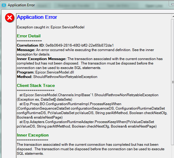

We have a configurator that works perfectly in 10.1.600, but when we run the same config in 10.2.600 we get an error with SQL not disposing correctly. (image below)

I’m getting the product specs on the config form so I know my connection is working, but when I complete my config I get the following:
It looks to be tripping up when it starts to perform KeepWhen evaluation but I’m not sure where. Is there a way I can debug this more specifically? I have no idea where this is failing and hence no idea how to fix it.

When the configurator completes and runs through configurator rules, it falls over at the first GetPartDefault that is called with the above errors about not being able to establish a DB connection because a prior connection wasn’t disposed.
I’m at a real loss about how to find the point where a connection is not disposed, as the code breaks at a different point. Do any of you gurus know how I can trace this error?
