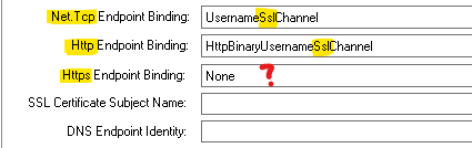

NET.TCP and HTTP, I do not see however the HTTPS version in the document nor in the EAC.
Anyway, net.tcp and http should work for your users when their client PC has imported the certificate from the server.

Https binding, like HttpsBinaryUsernameChannel will work as well, it does not use anything related to Windows domain authentication, only certificate is required
