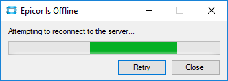

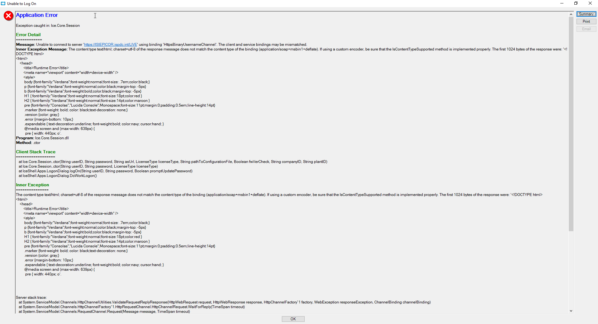

Upon trying that I immediately get this when I enter a username and password:
If I click retry it turns into this:
That looks like a certificate error?
Right will your Certs have to be valid and trusted. Even if internal they need to be installed in the clients. If your server has port 80 / 443 mapped to outside you can use Let’s Encrypt to get a valid cert for free.

Looks like I needed to use https://isiepicor.ispdc.int/LIVE instead of https://isiepicor/LIVE.
It tries to connect, but now I get a mismatched bindings message.
