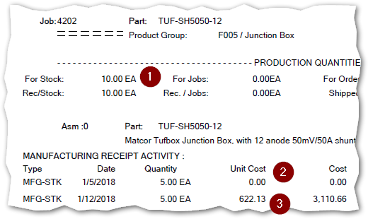

Al - We’ve discovered that the unit cost updates as $0.00 only when the Qty Received to stock is less than the production qty. Take this job for 10 EA to stock, that was received as 5 EA, two separate times.
The total cost for parts, for all 10, was $3,110 ( a unit cost of $311). The first receipt went in with zero cost, the second went in with cost of $622.
The value of inventory is maintained, as those 10 pieces (5 at $0 + 5 at $622) net to $311 each.

I tried to simulate a job where the job production qty was for 32 pcs. In piecemeal we received in 19 qty so far, but all of them had costs. There is still 13 pcs open but all the previous receipts were costed.
We use AVG costing method. So it would make sense that your receipts go in with a non-zero cost (the STD cost, actually).
Because the Part was transferred between two plants I have to combine the Part Tran History. Here it is…
Date Tran Tran unit Cost QOH ‘A’ QOH ‘B’ Part Cost After Tran
1/4/2018 Beginning Bal after QTY-ADJ in Plant A 0 2 $151.65
1/5/2018 STK-CUS plant ‘B’, Qty 1 $151.65 0 1 $151.65
1/5/2018 MFG-STK, Plant ‘A’, Qty first 5 of 10, no Qty reported $- 5 1 $25.27
1/5/2018 STK-PLT, Plant A -> B, qty 5 $25.27 0 1 $25.27
1/10/2018 PLT-STK, Receipt at B, qty 5 $25.27 0 6 $25.27
1/11/2018 STK-CUS plant ‘B’, Qty 2 $25.27 0 4 $25.27
1/12/2018 MFG-STK, Plant ‘A’, Qty final 5 of 10, no Qty reported $622.13 5 1 $356.86
1/12/2018 STK-PLT, Plant A -> B, qty 5 $356.86 0 1 $356.86
1/15/2018 PLT-STK, Receipt at B, qty 5 $356.86 0 6 $356.86
So the COGS for the two customer shipments on 1/11 were seriously under costed.
It seems like the weighted averaging is working except for the MFG-STK transaction that happened on 01/05/2018 which totally messed up your avg cost.

01/05/18 : MFG-STK = 5@$0 = $0 (was materials issued to job at this point? or was it done after the job receipt?
New QOH Unit cost = (1@$151.65 + 5@$0)/ 6 QOH = $25.27 new unit cost
Job production detail shows all materials were issued 1/4 (prior to the first receipt of 5 to Stock).
Your calculation of the unit cost after the 1/5 MFG-STK is correct.
Had the final 5 MFG-STK of the final 5 happened before any transfers or shipments, the unit cost would have been:
(6 @ $25.27 + 5 @ $622.13) / 11 = $296.57
which is the same as if the first 5 MFG-STK had been costed properly.
(1 @ $151.65 + 5 @ $311.07 + 5 @ $311.07) / 11 = $296.57
