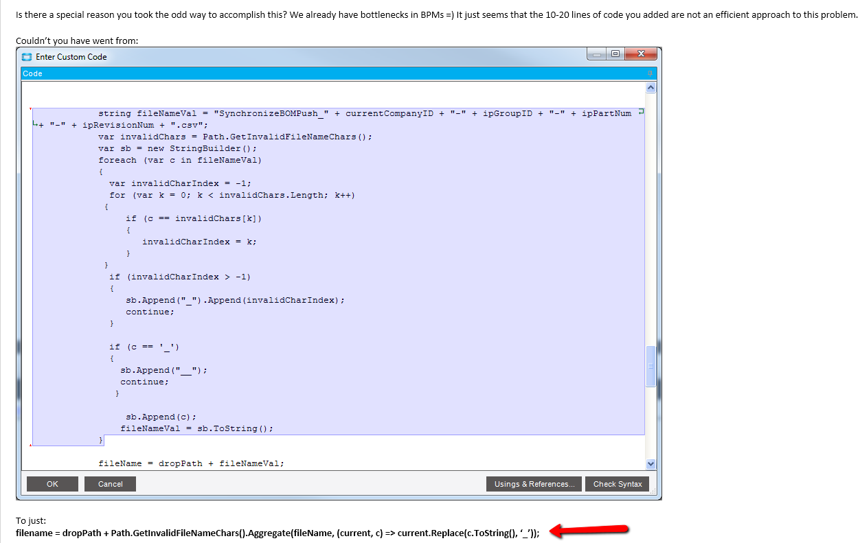

Their BPMs re-invent the wheel:

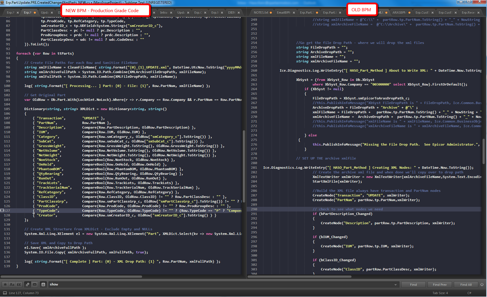

You have to rewrite almost everything :slight_smile: (left is new one after I was done)
