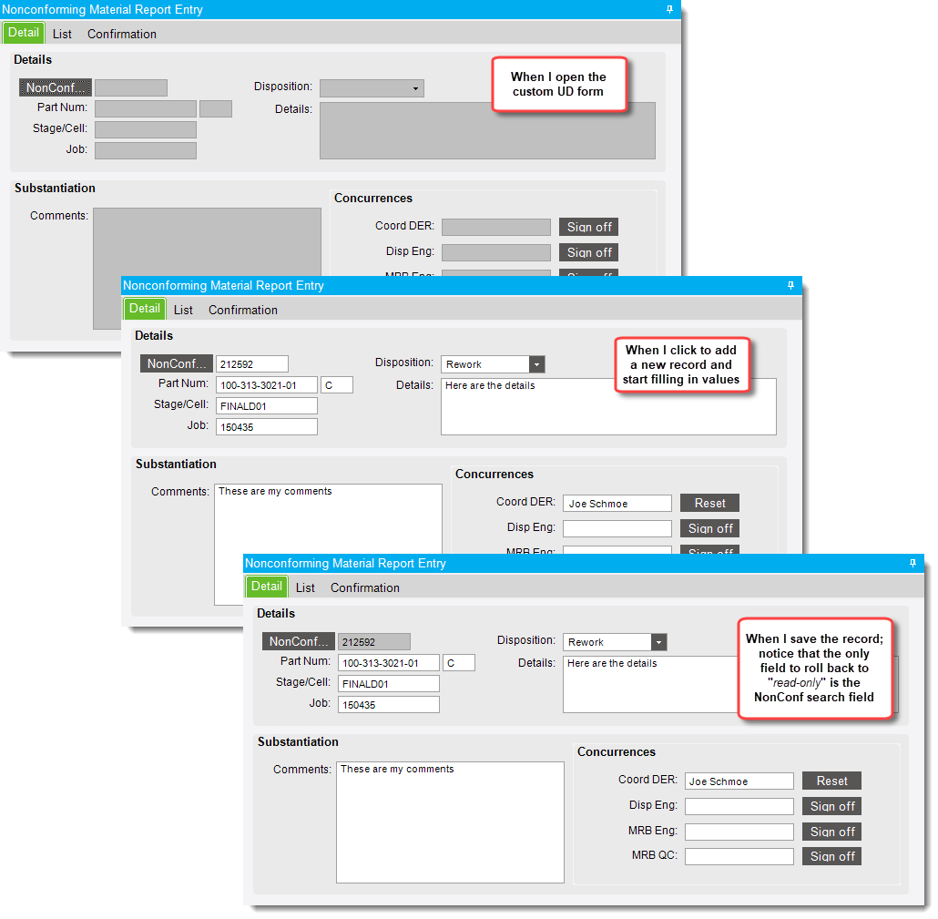

Might anyone know how I might be able to control/direct the state of UD form controls upon record save so that all controls on the UD form are converted to a “read-only” state? The UD form customization that I’m working on is meant to be a data-entry form, not a tracker - so I’d like the record to be saved and “locked”, unless a user needs to re-access the record to edit it.
Below is a depiction of current behavior:
You’ll notice in the bottom panel, the expected/needed behavior as exhibited by the NonConf search field. I’d like to see if I can get all other controls to mimic the read-only state upon record save.
Might there have been something to which I should have paid more attention during creation of the UD form?

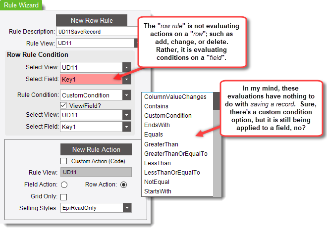

Joshua - I’m confused how to get that set up because the definition of a rule condition seems to be limited to choosing a specific field on the data view. More specifically, the rule condition as I currently see it, should be evaluated on “row save” (when a record is saved)… but the row rule dialog appears to only allow evaluations on fields in the data view rather than a row action on the form itself.
Example:
What I think I need to do -
“Did the user just save the data entered on the UD form?”
Yes - Set the ReadOnly property on all form controls to true.
How I’m interpreting what’s available in the row rule dialog:
“Does a specific condition exist for a specific field in the data view?”
Yes - Set a EpiReadOnly style on all form controls (perhaps accomplished through a custom code action)
Maybe I’m not thinking this all the way through; perhaps unable to witness the firepower of this fully armed and operational battle station wizard?

Chris -
I see where this would allow me to set the read-only property for a specific field to true or false, but…
My confusion is more with understanding the set-up of the Row Rule Wizard… because my mind is thinking I need to evaluate the state of a record/row (in this case, upon the deletion of a row), but the Row Rule Wizard is merely evaluating various conditions of a field (not a record/row).

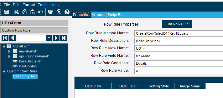

So this is how you do it. Make a row rule with the wizard. Doesn’t really matter what it is because you are going to change it, but to make it easier, make it so Key1=Key1. After you save, the row rules, you’ll change the generated code to something like this. Noticed that I changed the field key1 to RowMod and the Equals to “A” (Like @jgiese.wci suggested)
   private void CreateRowRuleUD14Key1Equals()
   	// Description: ReadOnlyHack
   	// **** begin autogenerated code ****
   	RuleAction[] ruleActions = new RuleAction[0];
   	// Create RowRule and add to the EpiDataView.
   	// Dummy Context Object
   	object contextObject = null;
   	RowRule rrCreateRowRuleUD14Key1Equals = new RowRule("UD14.RowMod", RuleCondition.Equals, "A", new RowRuleActionDelegate2(this.UD14Key1EqualsUD14Key1_CustomRuleAction), contextObject);
   	((EpiDataView)(this.oTrans.EpiDataViews["UD14"])).AddRowRule(rrCreateRowRuleUD14Key1Equals);
   	// **** end autogenerated code ****
After you change that save close and come back (I think you have to do that), the row rules should look like this in the properties.
There is another block of code that was generated with the wizard and it looks like this. You can put whatever you want in that section and it will fire when your row rule fires.
