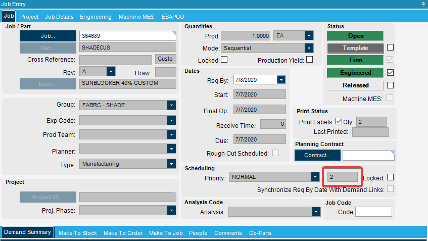

Hello all, I am having an issue where the textbox I have linked to a UD field is being forced to be read only. The field is only locked when the Engineered checkbox is checked.
After a bit of looking I found that everything on JobHead locks when this checkbox is selected.
However, this field is on a separate UD table so I’m confused as to why it’s being set to read only as well. Is there any way to force a single UD field to be not read only when Engineered is selected?
Also It is to my understanding that it is probably possible to “fix” this in company configuration by allowing changes on engineered jobs. We need to keep prevent changes on, I just need this one field to be able to be edited by the users.

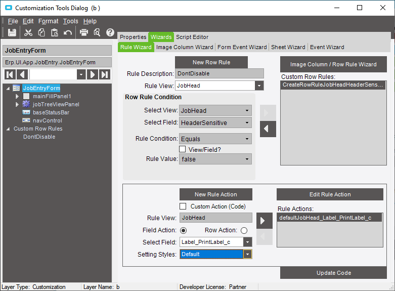

Have you tried the Extended properties wizard in the customization?
Yeah I was poking around there the other day and I set readonly to false. However, it seems like that either doesn’t work or it doesn’t stick.
Yeah I just tried a few things I though would work, and none did …

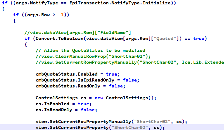

@josecgomez did this work, in Notify Event?
ControlSettings cs = new ControlSettings();
cs.IsEnabled = true;
cs.IsReadOnly = false;
view.SetCurrentRowPropertyManually("EmailJT_c", cs);
view.SetCurrentRowProperty("EmailJT_c", cs);

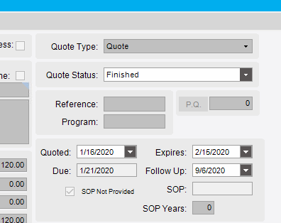

The only thing that seems to be doing the trick for me in 10.2.600 is:
// In EpiViewNotification Event
cmbQuoteStatus.Enabled = true;
cmbQuoteStatus.IsEpiReadOnly = false;
cmbQuoteStatus.ReadOnly = false;
The Quoted Date Fields you could debug, those are Epicor fields and see how they mark them avail when Quoted = true
But id like to see if I can make a RowRule with a custom condition and check for, but the problem might be that Epicor themselves are not using RowRules but just the helper to disable all controls…
Ideally something like this id like to see, i’ll need to poke around.
bool QuoteHed_CustomRuleCondition(Ice.Lib.ExtendedProps.RowRuleDelegateArgs args)
