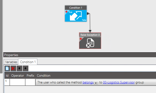

At the simplest level you can do:
Create a Security Group who can add part
Add users who need to create to group
Write PRE BPM on Part.GetNew
Add condition, select condition where USer is in sec group
if false, exception widget
