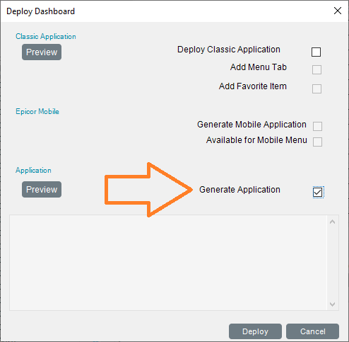

How do you do step 3?
I get that the customizing part is the KNTCCustLayer in Solution Workbench. But what is the dashboard itself? What is that file type?
Dashboard itself is just regular dashboard there’s nothing different to export. Export BAQ + Dashboard+KNTCCLayer
Then after you import into other environment generate web app + apply layer = profit
(works the same for published dashboard assemblies, with the caveat that Epicor will automatically publish your dashboard assemblies after you do it the first time or you can run a mass publish button)
Oh no… you mean this step?
So I will STILL need to do this manually?!
I think so though I haven’t checked recent versions.
