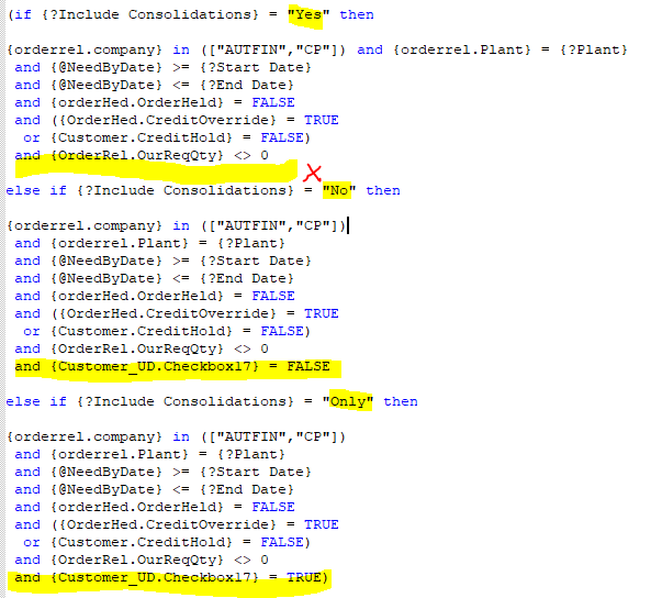

Was able to get the BAQ working as intended, however in the SQL report there is a dropdown that states include the parameter with option of yes, no, and only. Only the specified checkbox in true. No the specified check box is false, Yes the specified check box can be either true or false. How can this be done in the parameters of the BAQ menu?

Also, I can do basic filtering and parameters. The filtering in the picture seems advanced in that depending on the input by the end user of the report, a different set of criteria will be used to retrieve the data. I may be making this more difficult than what it actually is though.

You may want to look at another approach since this is not a simple baq report. I would only do reports this way.
