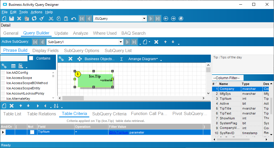

Like I said, it’s been a while, but you set up your BAQ to have a parameter (through Actions/Design Parameters menu item). You then set up the filter:
The “SQL” generated by BAQ from the Phrase Builder looks like this:
… normal SQL stuff …
where (Tip.TipNum = @MyTipNum)
Search for “Add Criteria Mapping” in Epicor help and you should see this:
You hook up the control from the Criteria Set to hook up to that specific BAQ’s parameter and life is good. You can hook that up to multiple BAQs as well.

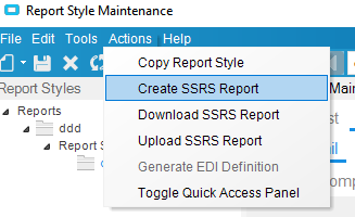

If you build your RDD and then create your style in Report Style Maintenance, you can just do a Action\Create SSRS Report and it will create you the template report just like in BAQ Report. Plus, you get all the data columns are mapped in for you. It should only take a couple more clicks to do RDD + BAQs instead of BAQ Report.
There is no reason to use the old BAQ Report… ever… again…

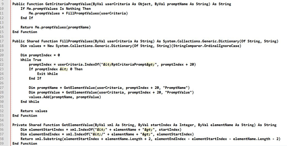

Also check out the code in the *.rdl created by Report Style Maintenance (also in the ReportTemplate.rdl). The methods help get criteria parameter values.

Aha!! Found it in the Global Code, ok that makes it much easier than adding the XML Values to SELECT :heart: :smiley:

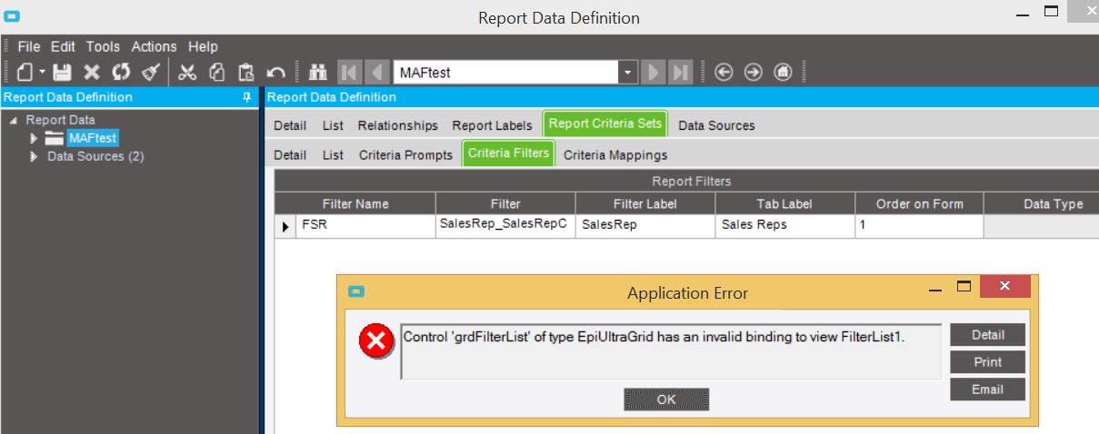

how does one get the control data type to match up?
i have a RDD/BAQ report and the criteria filter datatype is empty and read only - it does not match up to my criteria mapping field datatype which is nVarChar and pulled in from the BAQ
TIA
i then get this error
Whenever you have an error like this, please click the Detail buttons and copy/paste the text. Sometimes the extra information will tell us exactly what the problem is. At worst, it gives me a place to start looking.
Unfortunately, I didn’t work on the UI portion of this so I would have to spend a bunch of time to guess at the specifics of your issue and try to reproduce it.
sure thing…
Application Error
Exception caught in: Ice.Lib.EpiClientLib
Error Detail
Message: Control ‘grdFilterList’ of type EpiUltraGrid has an invalid binding to view FilterList1.
Program: Ice.Lib.EpiClientLib.dll
Method: EventSetup
Client Stack Trace
at Ice.Lib.Framework.EpiUltraGrid.EventSetup()
at Ice.Lib.Framework.EpiUltraGrid.set_EpiTransaction(IEpiTransaction value)
at Ice.UI.Rpt.DynamicCriteriaReport.FilterListPanel.set_ReportTrans(Transaction value)
at Ice.UI.Rpt.DynamicCriteriaReport.FilterPanel.BuildFilterPanel(Int32 filterID, String viewName, RptCriteriaFilterRow filterRow, Transaction trans)
at Ice.UI.Rpt.DynamicCriteriaReport.FilterPanel.AddCustomSheetToDockManager(RptCriteriaFilterRow filterRow, Transaction trans)
at Ice.UI.Rpt.DynamicCriteriaReport.FilterPanel.BuildDynamicFilters(RptCriteriaDataDataSet dsReportCriteria, Transaction trans)
at Ice.UI.Rpt.DynamicCriteriaReport.DynamicCriteriaReportForm.BuildUIControls()
at Ice.UI.Rpt.DynamicCriteriaReport.DynamicCriteriaReportForm.OnLoad(EventArgs e)
at System.Windows.Forms.Form.OnCreateControl()
at System.Windows.Forms.Control.CreateControl(Boolean fIgnoreVisible)
at System.Windows.Forms.Control.CreateControl()
at System.Windows.Forms.Control.WmShowWindow(Message& m)
at System.Windows.Forms.Control.WndProc(Message& m)
at System.Windows.Forms.ScrollableControl.WndProc(Message& m)
at System.Windows.Forms.Form.WmShowWindow(Message& m)
at System.Windows.Forms.Form.WndProc(Message& m)
at Ice.Lib.Framework.EpiForm.WndProc(Message& message)
