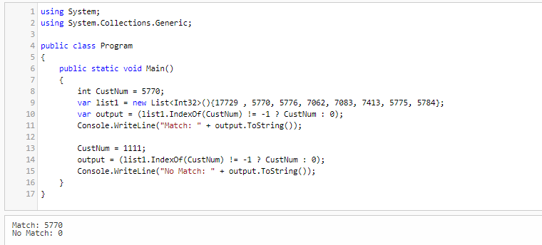

Google “c# case statement” but honestly the use of a switch in your use case is not necessary, because all of your conditions resolve the same. A single if statement like what @ckrusen posted would work fine. Below would be the code in a “standalone” situation
But that’s WAY to much hard coding (the specific CustNums). You really should add a UD field to the Customer table to identify these specific customers. Then use LINQ to see if that field is set. If so, then use the CustNum, else 0.

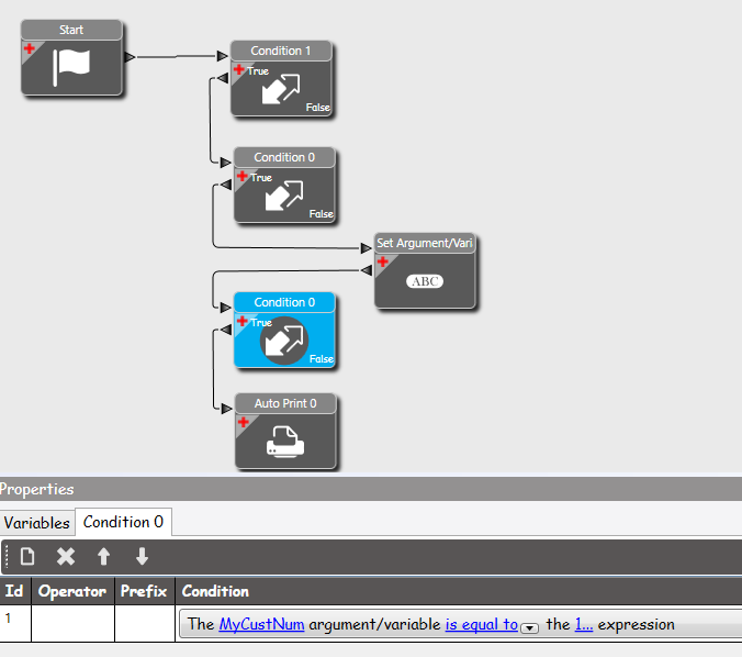

Yes you are correct. I have a set variable widget called MyCustNum where I am pulling the InvoiceHead.CustNum. Then I have a condition below where I am comparing the MyCustNum value to be equal to 17729 , 5770, 5776, 7062, 7083, 7413, 5775, 5784}. The condition is using and expression.
I had no idea how to do it until you asked. And that last solution(Array.IndexOf(....)) took some trial and error.
