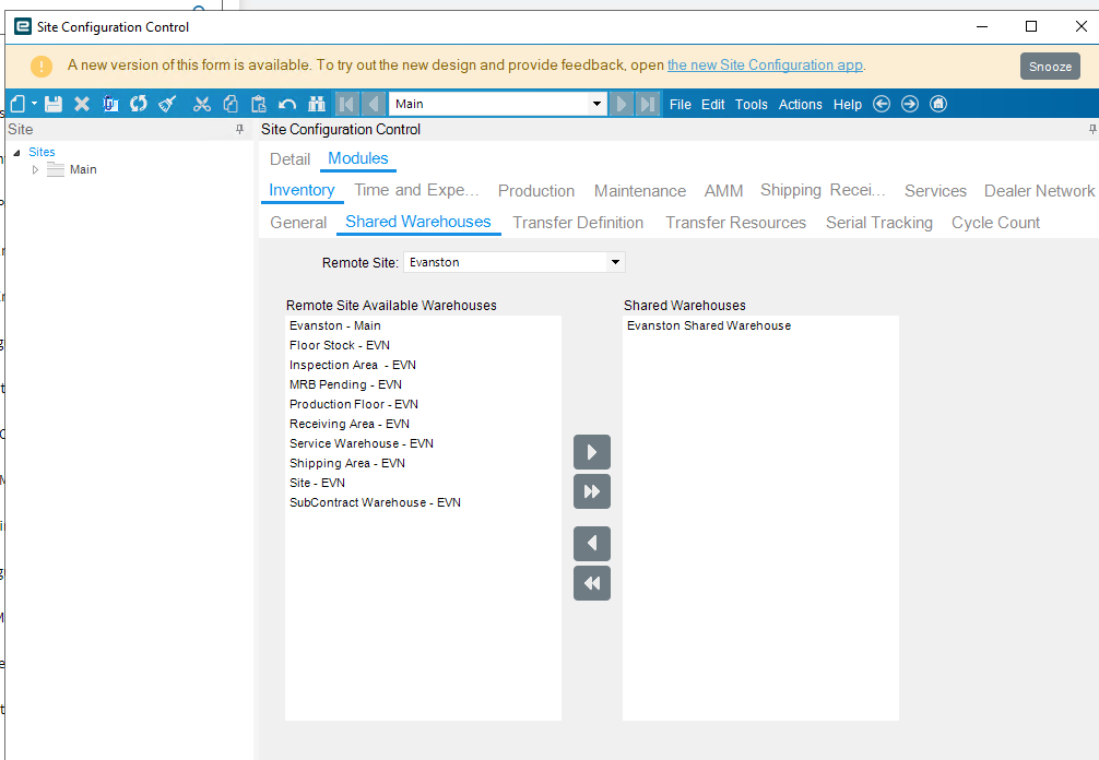

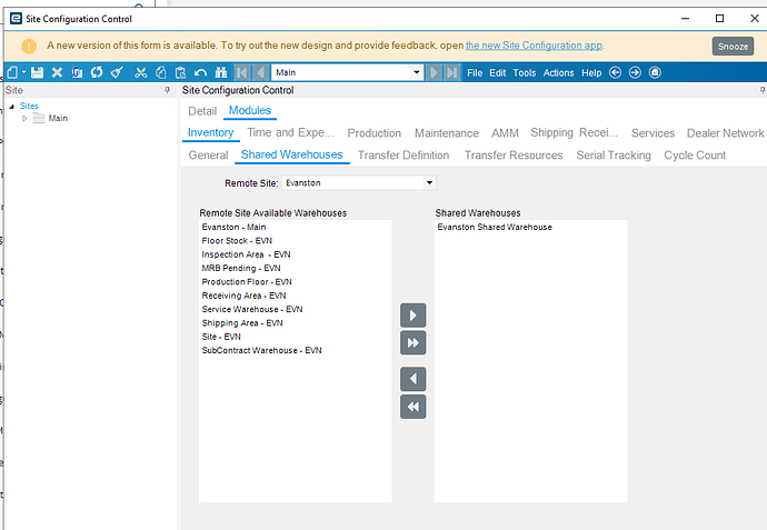

OK, do you know if I can move a warehouse from one site to another?
No I don’t think so, but you can explore the option to share warehouses
