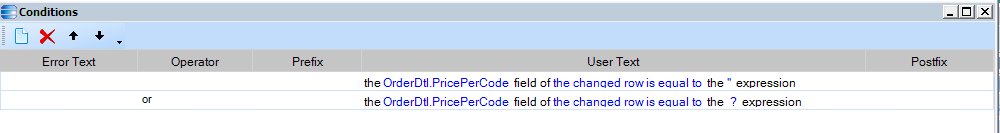

Hi, I am new to BPM ABL. I am trying to convert an E9 BPM for the OrderDtl to E10 but I have no concept at all. This is the BPM conditions:

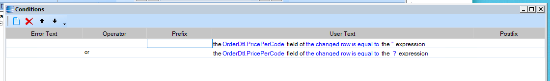

The conditions are:
in the code section is shows ‘’ and ? as seen.

This seems fairly simple.
It looks like it says, “If the PricePerCode on the OrderDtl row is “” or null, set it to ‘E’ and also set ShortChar06 to ‘E’.” However, I’m not sure what the use case is because according to help, this value comes from either the Part record or Defaults to “E”, so I don’t believe it can be null…

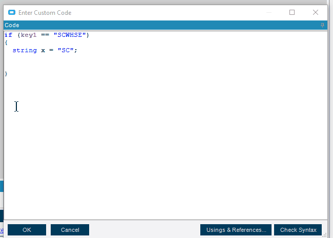

I know @josecgomez said not to use the converter, but I tried following the documentation and I was unable to write in the Programming Interface Generated Code window. No errors. I just could not enter any text.

Why don’t you just use the widgets? The condition is:
if the change row is empty or null
then
set field PricePerCode to “E” and ShortChar06 to 'E"
All of that can be done with the normal condition block and the set fields block, unless I am missing something here.
