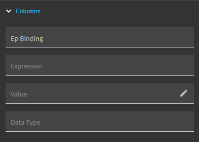

But then what do I enter here? I checked and using the row-current-set does set curDataRow to whatever I selected.
