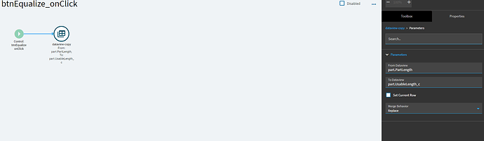

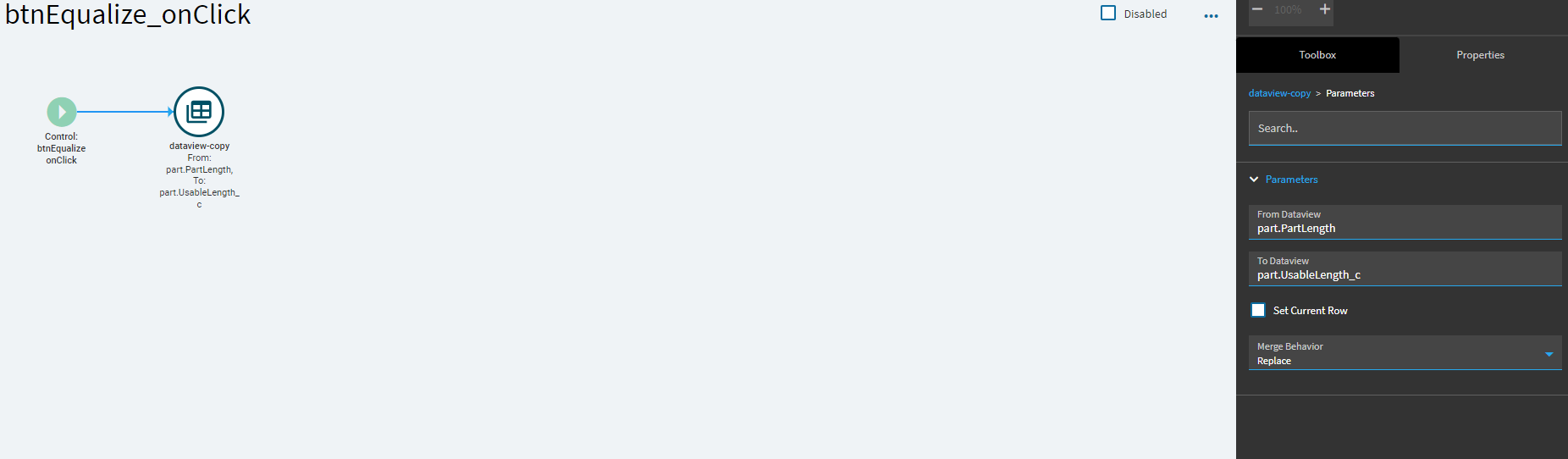

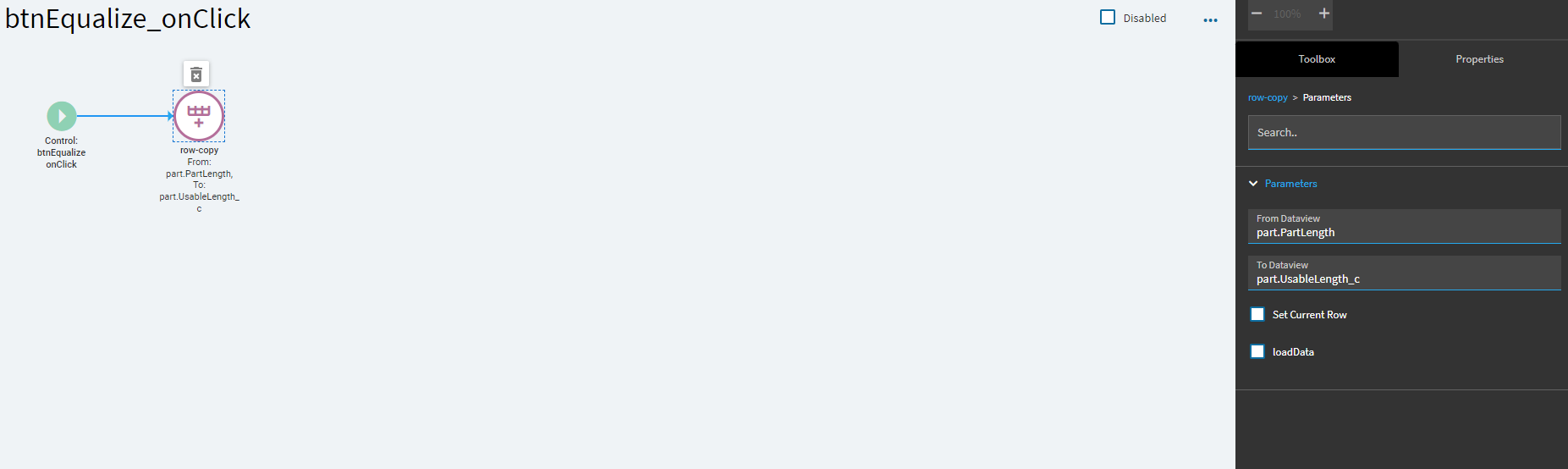

I am trying to make a button that when clicked, will make a UD column part.UsableLength_c equal to part.PartLength. Should I use row-copy or dataview-copy to do this? I tried both, but neither one is working when I am clicking the button.

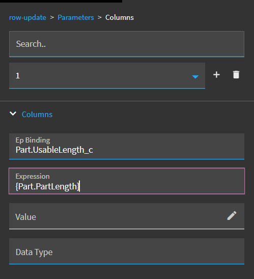

Since both of your fields are in the same data view, Part, you should be able to just use row-update and set the UsableLength_c field equal to the PartLength field. Something like this
Tried this, and it did not work.

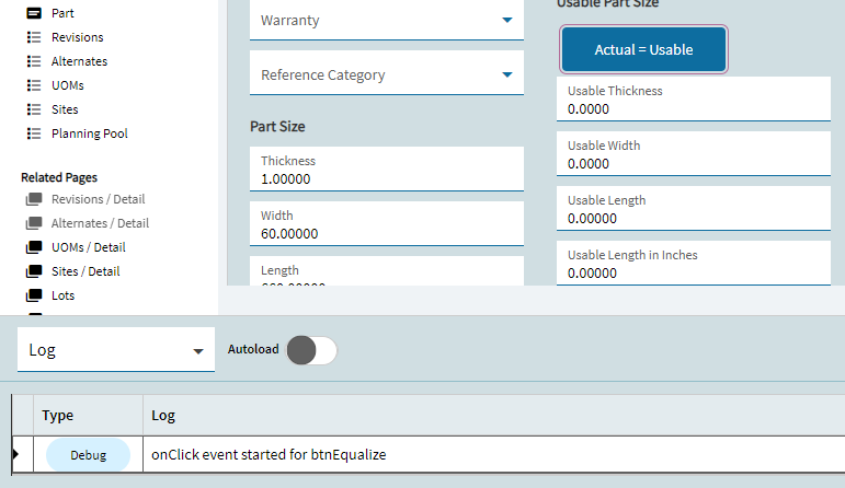

What did the chrome debug tools show was happening when that event fired?
It just said “onClick event started for btnEqualize”
EDIT: If you mean the browser dev tools, then I got “replace is not a function”

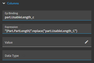

Alright I figured it out by looking at the following thread:
String replace (or other string functions) in application studio - Kinetic ERP - Epicor User Help Forum
It looks like I am supposed to put in “{Part.PartLength}”.replace(“part.UsableLength_C”) in the expression field
I still don’t think that is correct.
I mean it worked for me somehow. :person_shrugging:
