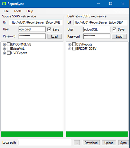

ReportSync is my tool of choice for this.
It allows one to migrade RDLs from one server to another.
Make sure you’re using the right Source and know where the destination is.

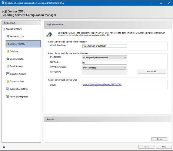

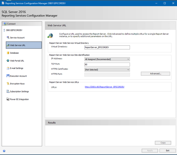

Use the Reporting Services Config Manager to find the URL
The URL for each Reporting Service instance in my case is as follows
http://yourReportingServer/ReportServer_Epicor[instance]/

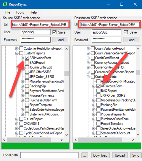

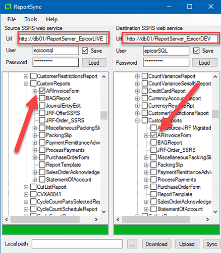

In this case, I am syncing my LIVE reports to my DEV reports for the AR Form Epicor report.

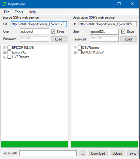

Be very careful that you know your source and destination…
Click "Sync" to move copy the Source selected contents to the Destination selected contents.
