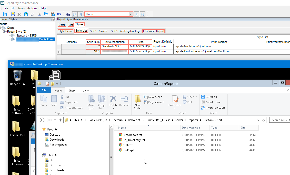

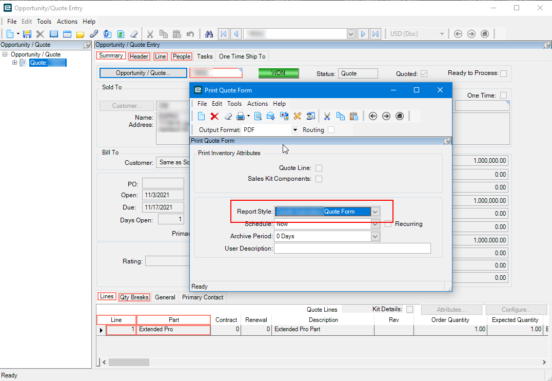

for example, in the image, I have the report style highlighted I want to use… where do i find that?

Would you know where i could find the report style i have on the pic?
Do you have access to the Report Style app (System Management → Reporting)?
yes but I dont see it there
correction, i found this, but the file doesn’t exist…
