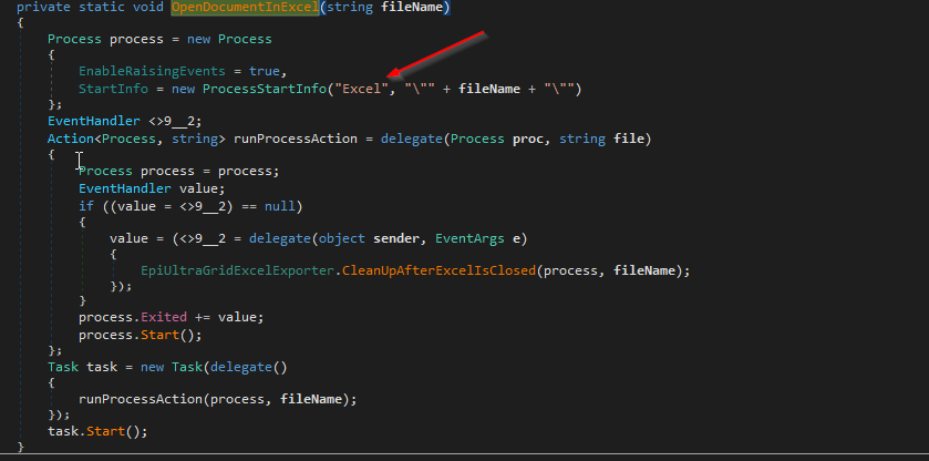

I wrote this little program like 2 years ago when I was having a similar issue, this program “detects” Excel the same way that Epicor does maybe it’ll help
