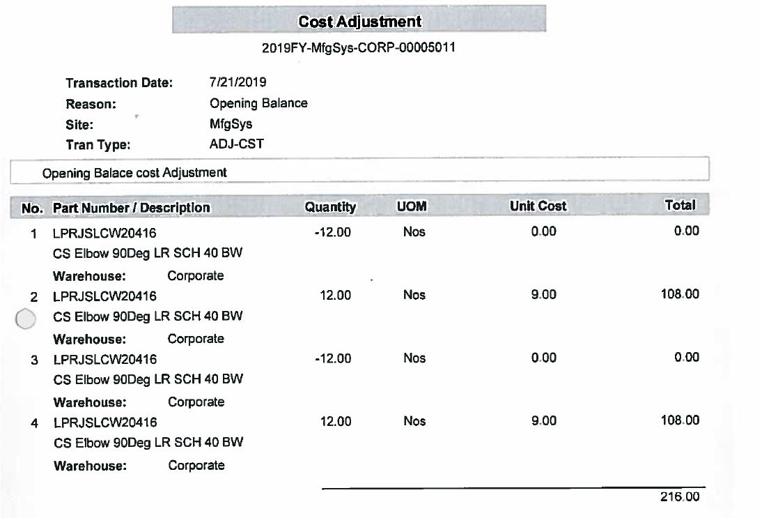

Dear experts, After Cost Adjustment there are four lines appearing for same part and quantity is showing double. Could you please explain why four lines appearing refer to attached screen
Do you use LAST costing? If I recall a cost adj for Last, will first adjust current QOH to zero then re-adj to the new value.

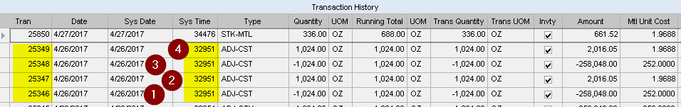

Actually, it makes 4 PartTran records and doesn’t affect the QOH
Note that
- All 4 parttran records (which are sequentiall numbered), have the same exact SysTime.
- the Running total is unaffected.
- In my example, the prior unit cost was $252, and changed to $1.97. Because the UOM is in OZ, bad the $252 cost is per gallon

Find sequential ADJ-CST trans, and look at the mtlUnitCost (rightmost column in my screenshot)

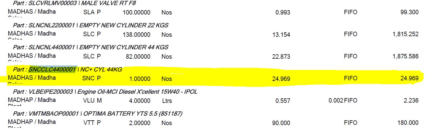

We have run the Stock Status Report up-to 2019-07-31. In stock status reports unit cost is 24.969 for Part -SNCCLC4400001. We have run the queries PartTran table up-to TranDate <= ‘2019-07-31’ attached in excel file. Quantity is matching with stock Status report but Unit Cost not. We are using FIFO Cost Method for this Part. Could you please let me know how to match the Unit Cost?

Stock Status Report ALWAYS uses the current cost, and not the cost back on the date selected.
(this is my number one pet peeve of Epicor)
