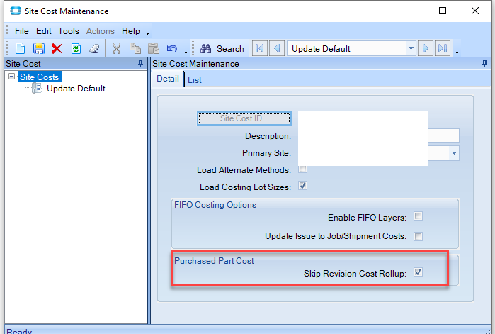

might be here:
Site Cost Maintenance
Ok, that is the checkbox that I remembered, but it is checked and this is still happening. May have to put in a case. Thanks for the help.
The screen shot above is from the Costing Workbench for me. I always un-check the “Consider Pull as Assembly Settings” because i don’t want lower level mfg. parts rolling all the material , labor and burden costs in to the material of the top level. I want to see then in their individual bucket.
The tell costing workbench to not rollup purchase part’s method, it’s in Site Cost Maintenance under Engineering > Setup
