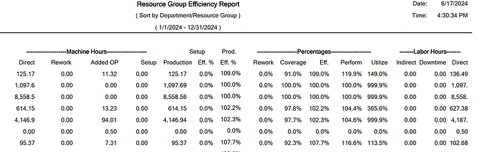

I’m a new user to EPICOR and am trying to get my company ready to go on to Standard Costing (currently system uses average costing). I’m trying to figure out a way to run a periodic (or via date range) report showing all the costed (earned) hours but haven’t found something I feel confident in yet. Does anyone know if there’s an out of the box solution or if you have to create a BAQ? I can validate that our system is costing jobs and applying labor all at average currently on the GL side, just looking for some operational reporting so I can use that for my basis in creating standards but want to ensure I’m grabbing the right hour figure. All I’ve found is the Resource Group Efficiency Report - is that the correct report? Also, all of our hours should be based on Labor Hours (Machine hours shouldn’t be costed as we are using our labor hours as base) and we shouldn’t have setup time included in the costing per unit (so would assume also not in the aggregate). Appreciate any help!!!
