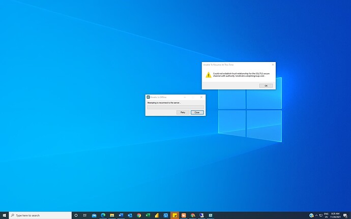

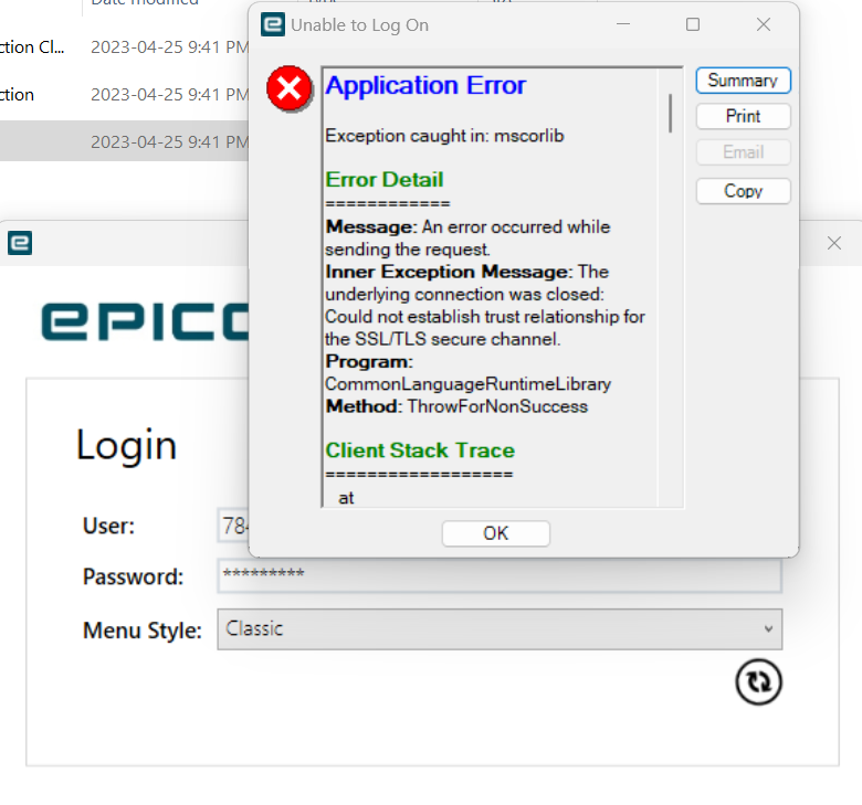

Getting this error message when i am trying to open Kinetic as smart client application.
Smart client is working directly in application server facing issue only when i am trying to install and access from client pc.
Unable to reach the server. Retrying…
System.ServiceModel.Security.SecurityNegotiationException: Could not establish trust relationship for the SSL/TLS secure channel with authority ‘kineticdrcs.dolphingroup.com’. —> System.Net.WebException: The underlying connection was closed: Could not establish trust relationship for the SSL/TLS secure channel. —> System.Security.Authentication.AuthenticationException: The remote certificate is invalid according to the validation procedure.
