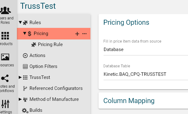

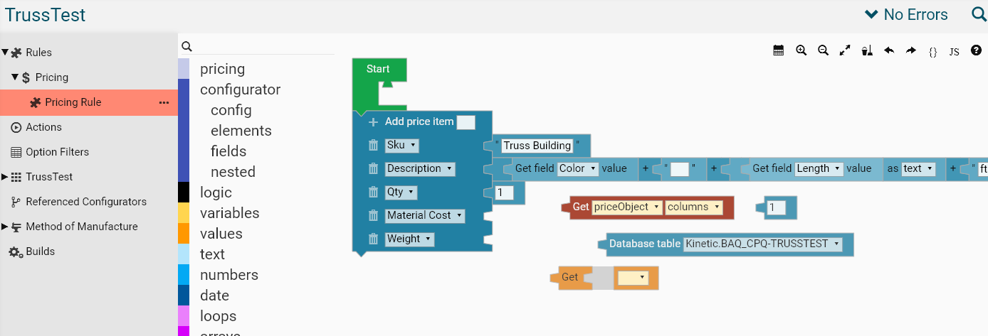

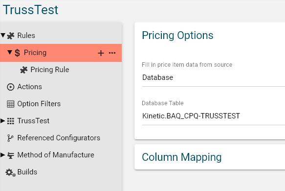

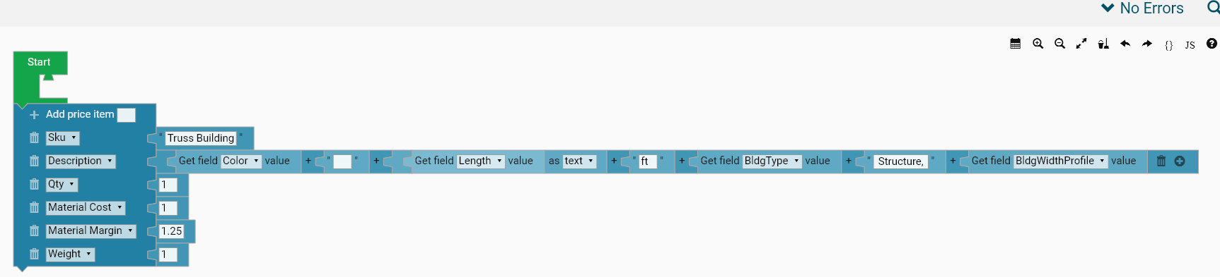

Now trying to figure out the snap logic to access the sync’d PartCost records. It output a price when I had static values set, but I’m not sure on the steps to join it to the BAQ table.

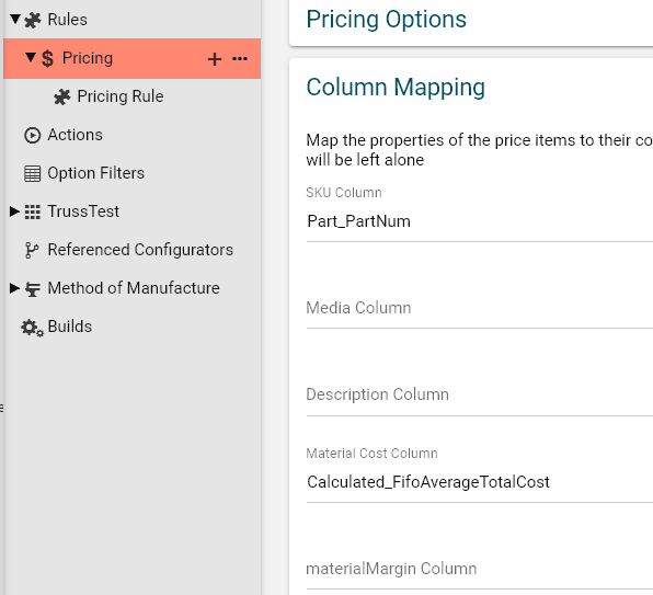

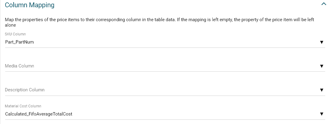

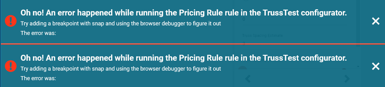

@kwolkens - Thank you. I think I’ve got the BAQ and BAQ Sync set up properly - The part cost and net weight show up in the CPQ table. I’m stuck at trying to figure out how to incorporate that in CPQ (so it’ll show up in the Pricing Rules).
