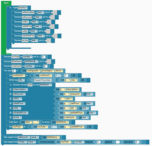

I am working on a configurator with an output document that must support an unlimited number of configurations.
(This configurator has an unknown number of child configurators–its up to the user)

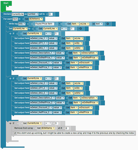

Currently, I have 2 sections of logic–Line Item and Line Detail.
Line Item - works fine, supports unlimited number of line items
Line Detail - technically works, but only supports what is specified
Combined, the output document looks like this:
The desired end result is a document which lists all line items on the first page, but each subsequent page expands on the line item as a line detail.
These line detail pages could be for Product A, Product B, Product C, etc.
To determine which configurator each line corresponds to, I intend to pass the configurator type as a global type, name, or message–whatever is less work.
I could manually set up the logic to support 50+ of each type of child configurator, but I was hoping to use something similar to an array of list to automate this process as manually setting up each section of the output document and snap logic would take a while and be prone to errors.
