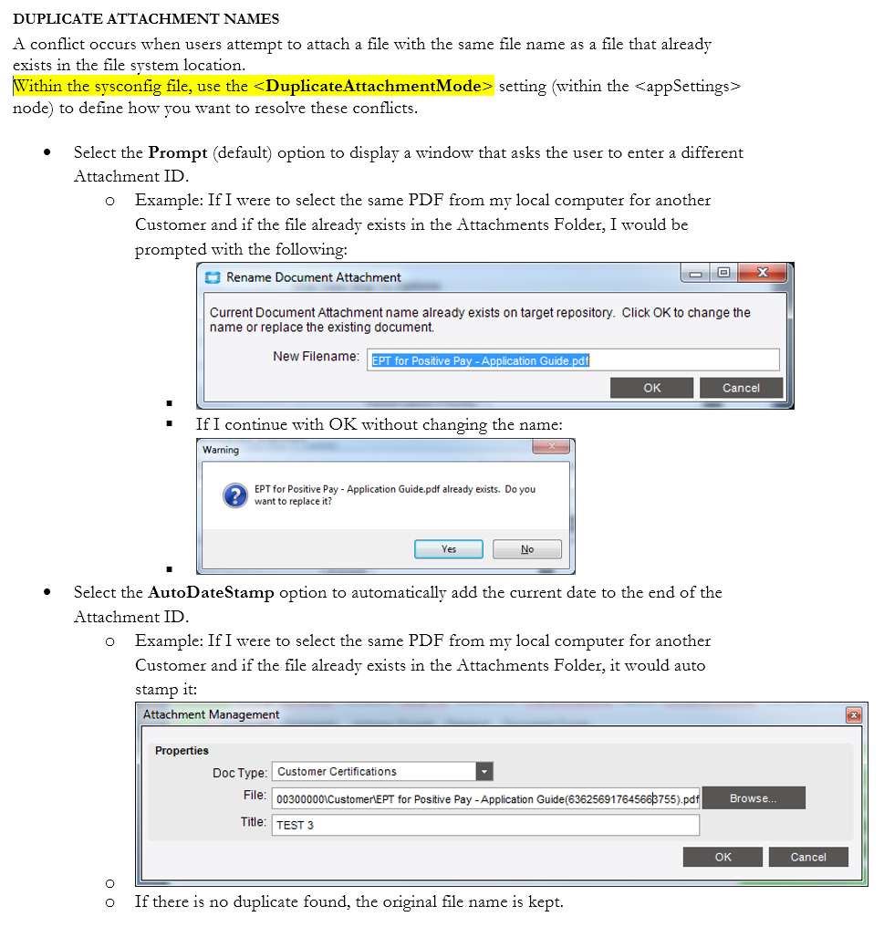

The Problem with Attachments is IF you have an Attachment and its name Invoice1.pdf and someone else tries to upload Invoice1.pdf to another Order he/she is allowed to OVERWRITE the other Orders Invoice1.pdf which is scary! so someone could have done that.

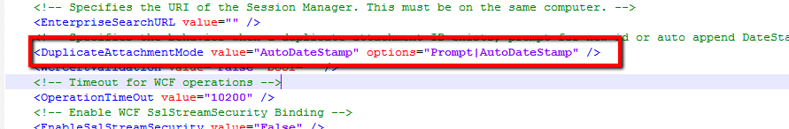

Your only way around this is on your server in your .sysconfig there is a AutoDateStamp feature you can enable which is disabled by default.
In other words you might have 100s of “incorrect” Attachments lurking.
WOW! Not cool! Sorry for the crazy question BUT, which sysconfig is it I need to change?
\YOURSERVERNAME\ERP10.1.500.0Deployment\Client\config\

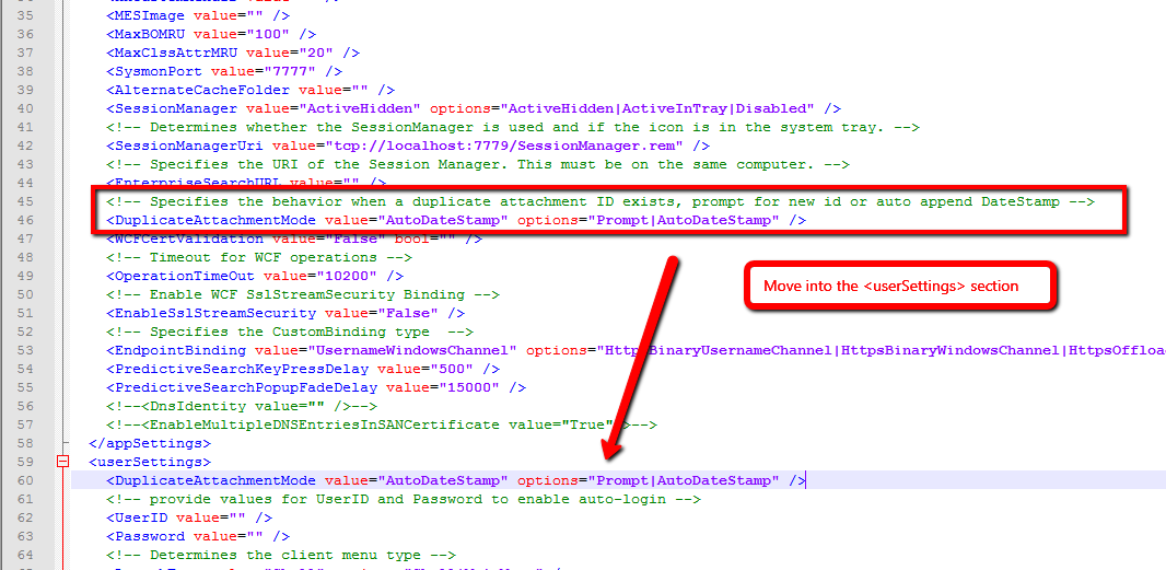

Another Gotcha if you do an Upgrade even a minor one it resets this sometimes to Prompt again. This should be Default if you ask me to stamp

If you move that property into the
<usersettings>
block, it will persist through updates.

Ok, slow guy here, explain move into the block?
So, first things first–just test what @hkeric.wci recommended and validate that it works as you expect. When you are happy, come back and I’ll have this updated to include the steps.

This was changed I think at 10.1.600.x to include almost all values in the .sysconfig for our Cloud customers specifically. In 10.1.500.x, a lot of items could be put into userSettings, but, not everything. If you’re on a release before 10.1.600, test it first ![]()
