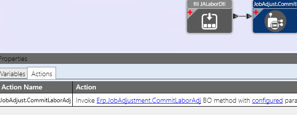

I just did something similar, doing a labor adjustment with a BPM, but I took a different approach. Even though I knew I could write it in C#, I decided to do it all with Widgets.
  1. add widget 2 Invoke BO Method… inside that define the method, and the variables. It automatically will create the needed variables for you (after you give them a name)
  2. Add widget 1 to “fill” the newly created variable for the LaborDtl record with the new adjustment you want.
    connecct the two widgets…
    Note that filling the LaborDtl requires all the necessary data. Some can be hard coded, some can come from other variables or BPMContext variables.

You would need to make a new LaborDtl with the adapter which will handle the laborDtl Sequence, SysRowID and SysRev. You don’t need LaborHedSeq since this would be like a backflush not done by a clocked in employee.
