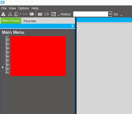

How is that second level? I am looking at the menu right now and the Top Level is the “Site” if you have multiple sites and then that’s it…
Are you looking for something above the “Label” Main Menu? cause that’s not a menu Item that’s just the Header for your menu…
Can you show me a screenshot of what you are seeing that makes you think it is the second item?

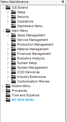

I would like it to look like this:
where MY NEW MENU does not have a parent. This is to achieve a custom menu layout that will not be modified when epicor updates are released that change the standard menu structure.
Your custom menu’s wouldn’t be changed when you upgrade… only the standard menus… Either way you can’t do that with the current toolset.
But if you create your own Submenu on “Level Two” as you call it, that would be completely custom and wouldn’t get moved with upgrades.
Though frankly the whole endeavor doesn’t make much sense, is there a particular reason you are going through all of this (other than to avoid epicor changing a menu once in awhile) Creating your own custom menu from scratch brings on security implications you need to setup new security groups, and access and everything else.
Hmm. Even if you did, the Mobile, Processes, and Time and Expense menus don’t display in the Client and your custom menu wouldn’t either.
