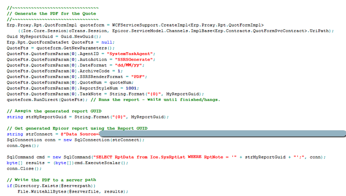

Good morning Mega-Minds! I’ve created a method in a Dashboard button click event that creates a new quote with a selected ProjectID, and then it adds parts to the quote. I also want it to automatically run the SSRS report for the quote as a PDF, then copy that PDF to a folder. I’ve got the quote creation and part adding parts working perfectly, but the running of the report and PDF creation is where I’m running into issues. The image below shows all the code I’ve put together from various website articles regarding this topic…

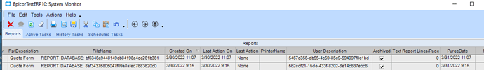

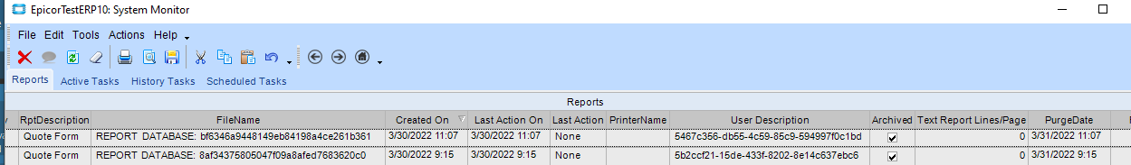

The first part runs the report, and it even shows up in the Epicor System Monitor as having been run…

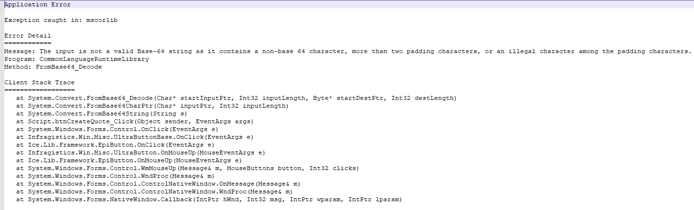

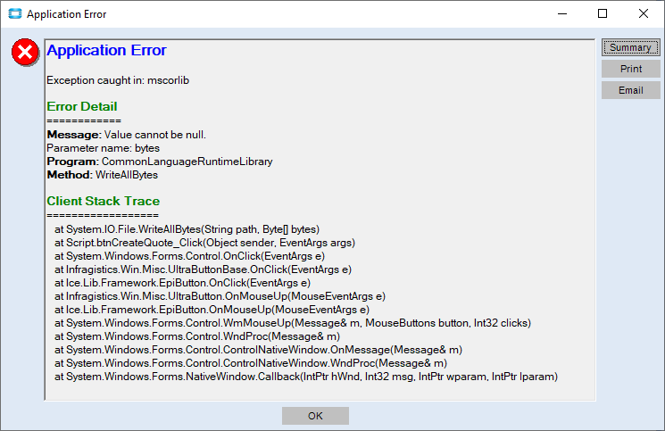

But the PDF portion gives this error…

Please don’t ever connect to the database from the client. That is a supremely bad idea particularly for security, upgradability , maintenance, and everything in-between.
You can accomplish the same by running a BAQ.
How would you run a BAQ from that code block?
There are a ton of examples of this in the forum.

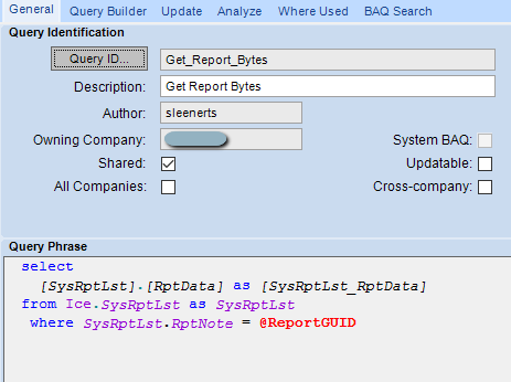

Thanks Jose! I get that I can create a BAQ to get the info I need from the database table. But how do I get the PDF of the SSRS report? Ultimately, all I’m trying to accomplish is running the report with the new quote number that’s created and then generate a PDF file that can be placed in the quote’s folder.
You need to the the bytes out of the RptData field and write them to a file like you are doing.

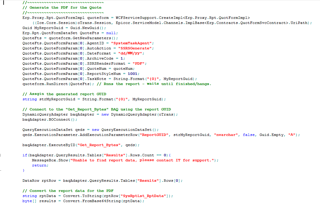

I created a BAQ to retrieve the report data like @josecgomez described, but when the code runs I get this error…
The image below shows my code so far:
At the end, I convert the object “SysRptLst_RptData” to string and then convert that for the byte[]. What should I convert the object into?
So you don’t have to convert from base64 because you aren’t making the call I’ve rREST
You should.be abke to just write the bytes as they come out of the BAQ

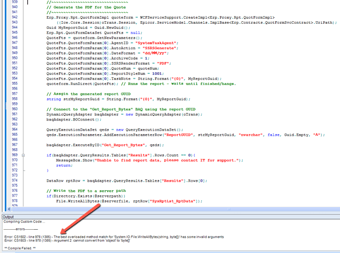

I tried just writing the bytes with the BAQ object, but I get this compile failed error…
Cast it to to a byte array first.
Cast like Jose did in the previous post:
Trigger ARInvoice Generation from API - not totally getting it - ERP 10 - Epicor User Help Forum (epiusers.help)
Because you are using the adapter that byte array is not a base64 encoded string, so you don’t need to do toString or anything else just cast to a byte array.
File.WriteAllBytes(@serverFile,(byte[]) rptRow["SysRptList_RptData"])
I got it working! Thank you @josecgomez and all the others! You are the Mega-Minds that help the rest of us navigate Epicor.
Here’s the BAQ I created to get the report data…
