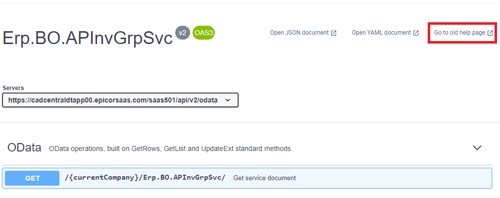

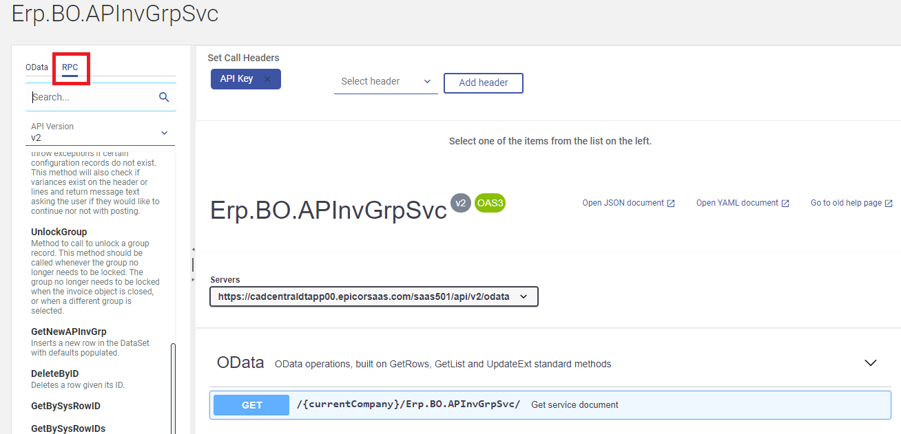

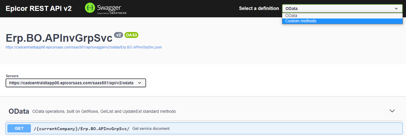

You can see the signature also by switching to the custom method list for any BO in the swagger. There should be a link on the top right of the page.

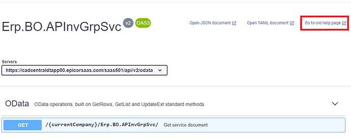

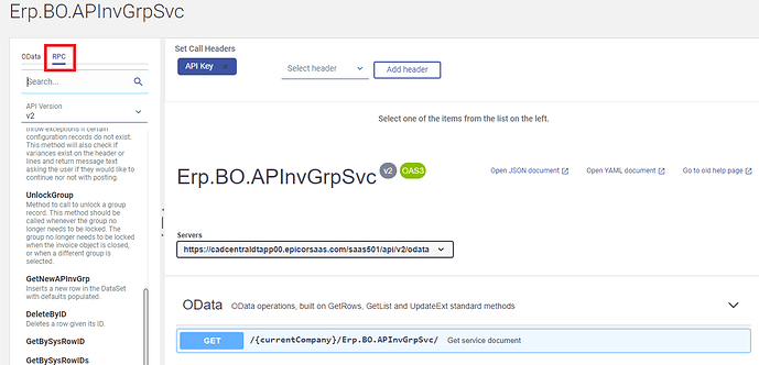

Thanks for this tip Joseph! For anyone using the new Swagger UI, the trick is to press on RPC on the left side or you can switch to the old help page and then change OData to Custom methods in the top right.
