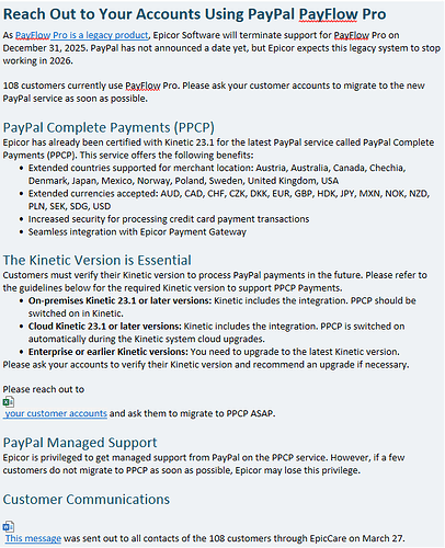

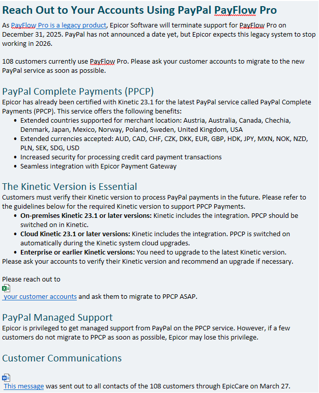

We are having the same issue and this is what support told me…
Epicor is aware of this problem, the DevOps team is actively engaged with PayPal on finding a resolution, and information on that progress has been shared with key members of the Kinetic team. There is no ETA for resolution as both parties are exchanging failure information so they can troubleshoot the problem. *
**With that said, this is a legacy platform for PayPal they are phasing out so we are not sure how much effort they will put into prioritizing the resolution. We would highly recommend moving to the new PayPal platform a bit more aggressively if possible.
Customers were already notified that now PayFlow Pro is a legacy product for PayPal and will be out of Support soon, we recommend to migrate their merchant account to the new PPCP, to do this they should reach out to their customer account.

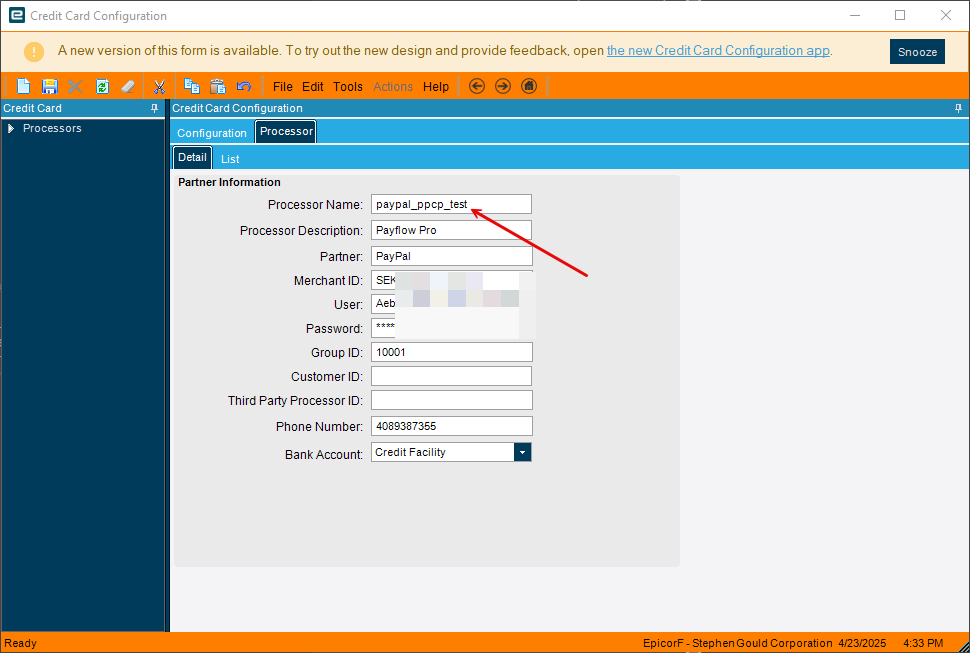

@josecgomez … does ebizcharge have a place here? Do they integrate with Epicor the same way this epicor module did?
I don’t know about “the same way” but yes they integrate with Epicor
This seems to be an issue with the way that Paypal is setup in these specific instances. We use EPX and we haven’t had issued with Paypal. You can configure it to use PPCP quite simply
Any reason you think they say you need to be on Kinetic to use PPCP?
