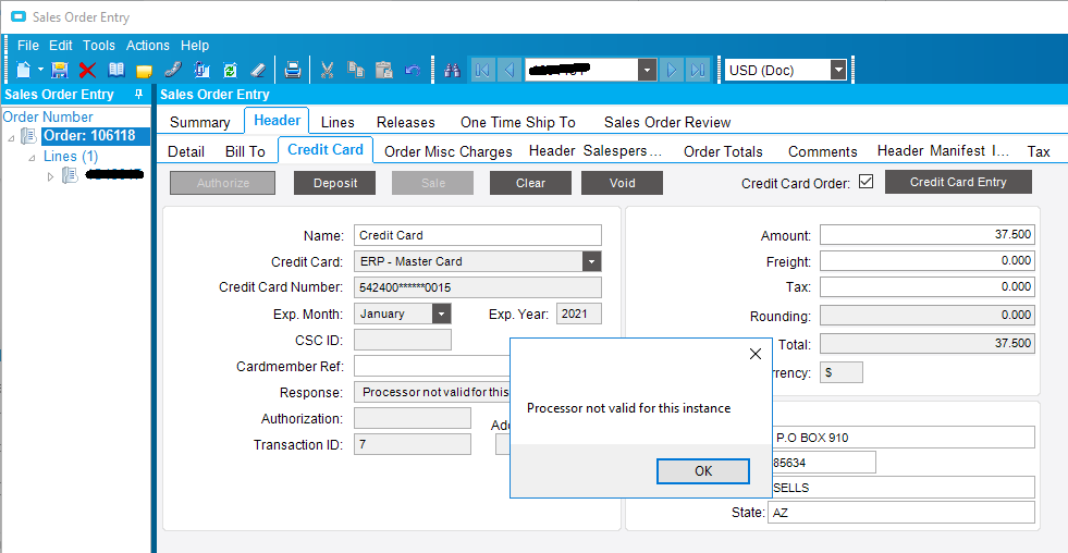

Have created sales order with testing credit card values but when i authorize it, it has showing …
Did I miss any installation related to credit card processing?
Did I follow the wrong process?
How do I setup processor details in credit card configuration setup form?
Request to provide your assistance to accomplish the task
Thank you.

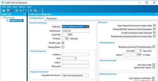

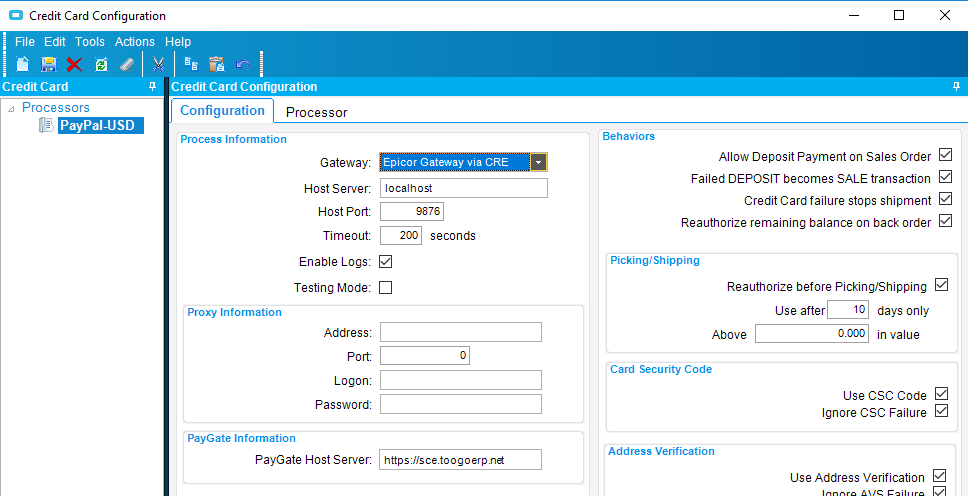

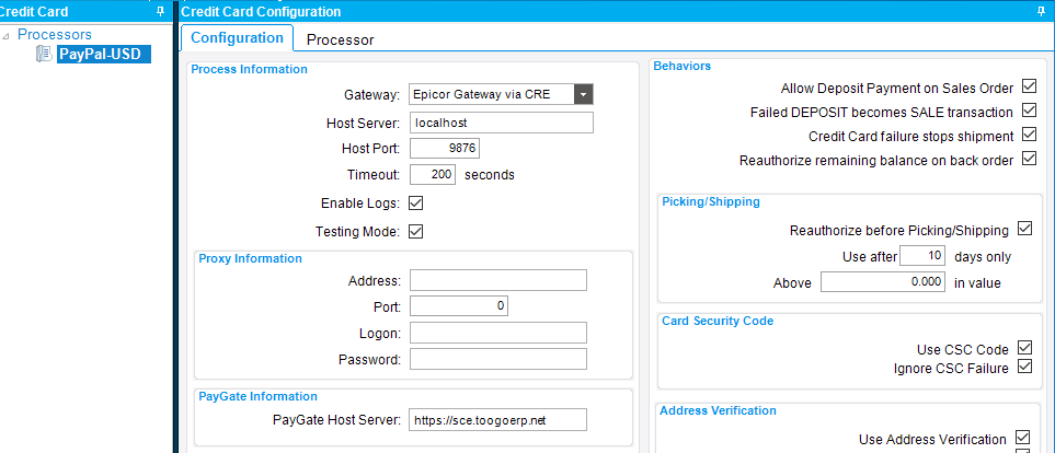

In Credit Card Config what does the Config tab look like.
Thanks for your prompt response
Here is the screenshot…

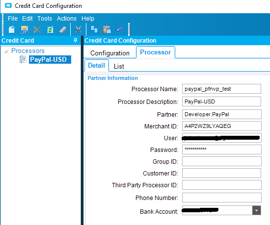

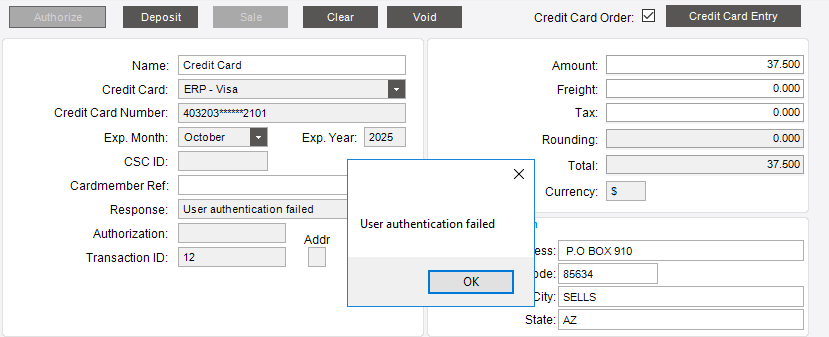

i have managed resolved the previous issue but now i am getting “User authentication failed…” please help me on the setup!, Below are the correct configurations?
My current configuration
Hello Pritesh, Were you ever able to work through this issue? We have a multi-Company configuration and have one company that recently started getting the same “User authentication failed…"
I know this thread is a few years old now, but hopefully someone can help me out.
We are working on implementing Epicor and struggling to get it to work with Paypal. We are having the same exact issue with User Authentication failed.
We have tried so many different combinations without any luck. Even the current credentials we use with current ERP system do not work.

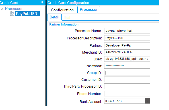

At least in our case it turns out that entering your Merchant ID isn’t really what it wants.
It wants the User ID you used to create the account. The User field can be the same User ID or typically a separate account you make that just has authorization rights.
