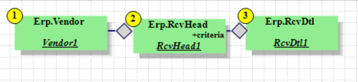

Here’s the top level query, highlighting the link between the SubQuery and the Vendor table:

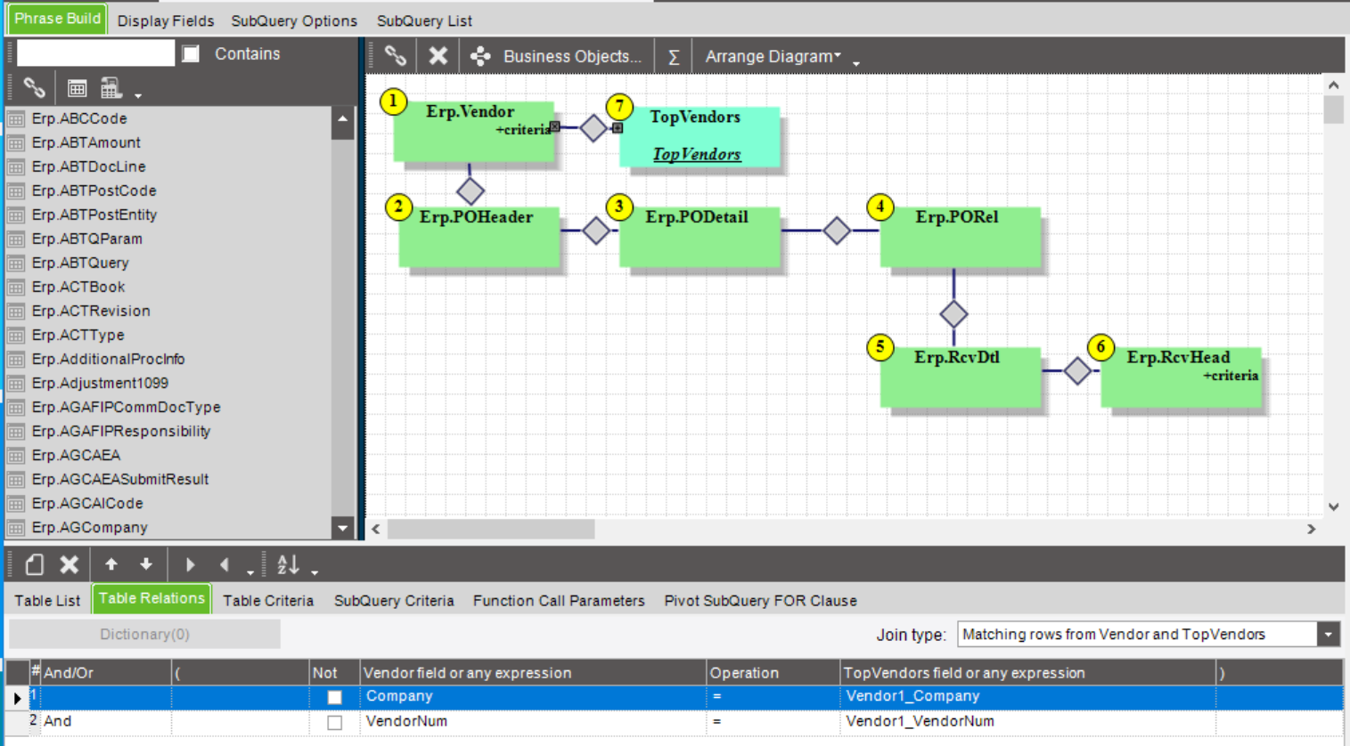

And the SubQuery itself:
try turning the sub query “TopVendors” into a CTE Query instead of an inner sub query so that it only needs to run one time. it might go faster.
also, wondering why your sub query is also retrieving the vendor table again. Why not have the subquery link to the supplier number directly in the rcvhead instead?

@timshuwy: Thanks for the tips! Eliminating the Vendor table from the SubQuery got the execution time down to ~13s, which still seems slow but is good enough. I also tried turning it into a CTE, but that didn’t give any further improvements.
