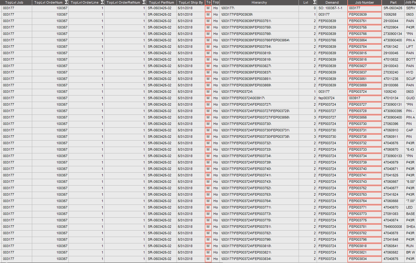

The way I did my CTE is I always maintained the Top-Level Columns, Showed an Hierarchy for Sorting…
  • Top Level Job
  • Demand
  • Job Number
This is where I started… First made a SQL Prototype for me this was related to JobProd (Job Demands) https://www.essentialsql.com/recursive-ctes-explained/ (they have the Hierarchy stuff on the bottom )

Haso - I took your suggestion to maintain the top-level columns and to add in the hierarchy to help with the top-to-bottom and the bottom-to-top sorting, should the user need that capability. It also helped to allow the user a way to “visualize” the hierarchy, as well. I added in a separate Sales Order BAQ to populate and filter when a record with the upper assembly is selected in the “part grid”. The bottom right panel merely maintains the sales orders (using the same BAQ) for the originally searched part number.

Note for anyone reading this… In Order to make my Hierarchy Searchable in a Dashboard… I did add a JobNum: textbox via a Customization and when the User fills it out and Text Changes it populates the Actual Hidden Hierarchy Search field with
*\word\*
Since its a Matches Field and my Hierarchy is split by Slashes
And if Blank then it sets the Hierarchy Field to “”
