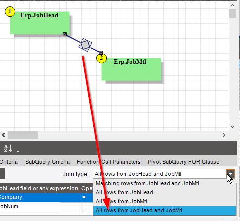

I am trying to get a monthly count of quantity of parts on order, suggested quantity to order, and the demand quantity. These all use different tables, with different date columns, so I set up a CTE with two unions to combine them. It mostly works, but I have a feeling I didn’t set up my dummy columns correctly; I create calculated fields set to null to make sure the CTE/unions have matching columns.
Results (e.g. rows 5 and 6 should be combined so that it has both open qty. and required qty.):
CTE:
Unions:
SubQuery list:
