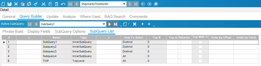

BAQ Combine multiple subqueries
Hello - I have two BAQs, one that returns the total value of orders added by customer for the current month and one that returns the total value of orders shipped by customer for the current month. Both BAQs work separately but I am unsure of how to combine them so that in a single BAQ I get the total orders added and total orders shipped by customer for the current month.
I attempted to combine them but get a bad SQL statement error. All of my subqueries are “InnerSubQuery”. I am guessing I need to incorporate “Union” or “CTE”.

Yes, CTE would be the way to go (IMO). Change both queries to CTE and then make a third query as a Top Level. Add both queries to the 3rd query as tables and join on like fields and you should be good.
Thank you! I got it to work
@jkane I am having one more issue - the combined BAQ is omitting a few customers who did not have anything ship but did have orders added. When I create the “OrdersAdded” BAQ separately I get a full list of our customers with every customer either having a value for the amount of orders added or a 0 but this is cut down to only those that had shipments when I combine everything. How can I retain the full list of customers and keep the query from omitting customers who may not have any shipments in the current month?

For the Join Type between the two CTE Tables, make it a full outer join (All Rows From Table1 and Table2 in Epicor speak).
This will make sure that regardless of the other table, all records from each table will show.
Simple as that, thank you!
