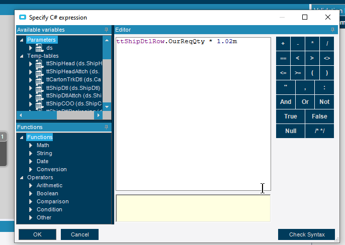

I think you can do this without link of the the dynamic query.
use this condition
use this formula to check
Keep in mind that if you do this, you will not be able to ship anything partial (if you do an exception instead of an info message)

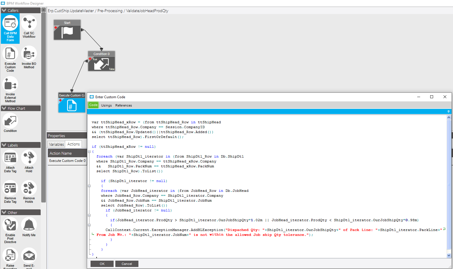

Hi @carlawhite,
i have done few BPM’s on this area using code, i have altered my code to suite what you want, please let me know if this will work in your environment.
the code as text:
var ttShipHead_xRow = (from ttShipHead_Row in ttShipHead
where ttShipHead_Row.Company == Session.CompanyID
&& (ttShipHead_Row.Updated()||ttShipHead_Row.Added())
select ttShipHead_Row).FirstOrDefault();
if (ttShipHead_xRow != null)
	foreach (var ShipDtl_iterator in (from ShipDtl_Row in Db.ShipDtl
	where ShipDtl_Row.Company == ttShipHead_xRow.Company
	&& 	ShipDtl_Row.PackNum == ttShipHead_xRow.PackNum
	select ShipDtl_Row).ToList())
		if (ShipDtl_iterator != null)
		foreach (var JobHead_iterator in (from JobHead_Row in Db.JobHead
		where JobHead_Row.Company == ShipDtl_iterator.Company
		&& JobHead_Row.JobNum == ShipDtl_iterator.JobNum
		select JobHead_Row).ToList())
			if (JobHead_iterator != null)
				if(JobHead_iterator.ProdQty > ShipDtl_iterator.OurJobShipQty*1.02m || JobHead_iterator.ProdQty < ShipDtl_iterator.OurJobShipQty*0.98m)
			CallContext.Current.ExceptionManager.AddBLException("Dispached Qty: "+ShipDtl_iterator.OurJobShipQty+" of Pack Line: "+ShipDtl_iterator.PackLine+" From Job No.: "+ShipDtl_iterator.JobNum+" is not within the allowed Job ship Qty tolerance.");
Note: as @Banderson said this will stop dispatching everything outside this tolerance.
HTH

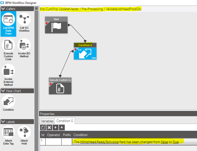

Hi thanks ever so much for your advice. I used your code, and placed it where stated, it works - however, its runs the BPM at time of clicking Shipped on the shiphead
This is too late for our process- it needs to be when the OurJobShipQty is changed. or line is saved.
I tried manipulating your code and placing it on shipdtl in transaction- but still cannot get it working.
thanks in advance

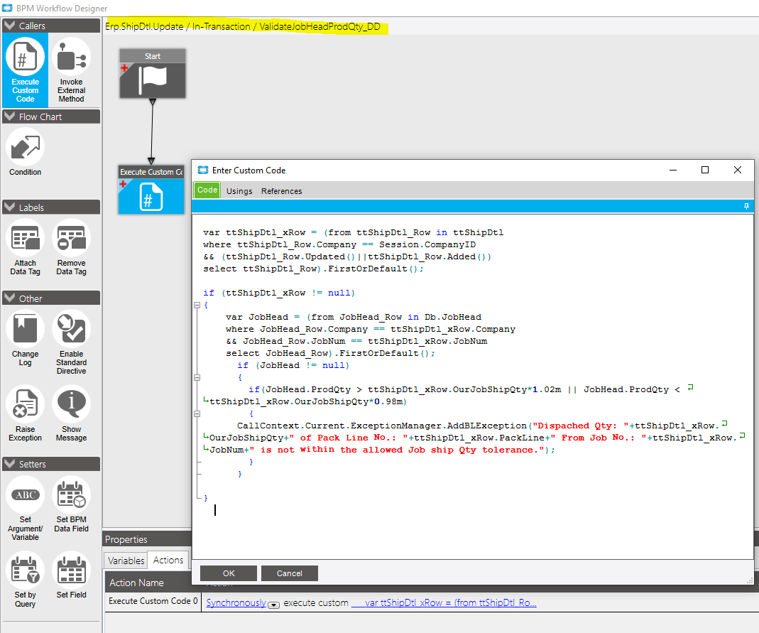

try this, i have re coded it, but used In-Tran data directive on ShipDtl, so it will be triggered on both actions as well as changing Row (notification) event which should give users the early warning as you want
var ttShipDtl_xRow = (from ttShipDtl_Row in ttShipDtl
where ttShipDtl_Row.Company == Session.CompanyID
&& (ttShipDtl_Row.Updated()||ttShipDtl_Row.Added())
select ttShipDtl_Row).FirstOrDefault();
if (ttShipDtl_xRow != null)
		var JobHead = (from JobHead_Row in Db.JobHead
		where JobHead_Row.Company == ttShipDtl_xRow.Company
		&& JobHead_Row.JobNum == ttShipDtl_xRow.JobNum
		select JobHead_Row).FirstOrDefault();
			if (JobHead != null)
				if(JobHead.ProdQty > ttShipDtl_xRow.OurJobShipQty*1.02m || JobHead.ProdQty < ttShipDtl_xRow.OurJobShipQty*0.98m)
			CallContext.Current.ExceptionManager.AddBLException("Dispached Qty: "+ttShipDtl_xRow.OurJobShipQty+" of Pack Line No.: "+ttShipDtl_xRow.PackLine+" From Job No.: "+ttShipDtl_xRow.JobNum+" is not within the allowed Job ship Qty tolerance.");
Note: we do not ship from manufacturing in my environment but i advise you to use the code to validate against Part No. as well, because Epicor will allow MFG-CUS Transaction from any Existed Job No.
HTH
This has worked beautifully - many thanks for your support much appreciated!

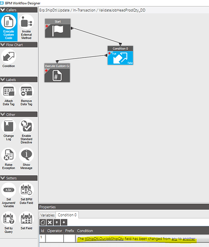

you can add a widget condition saying when ttShipDtl_xRow.OurJobShipQty changed from any to another and see how Epicor will behave on both BO (i.e. Cust Shipment and Invoicing)
cheers- I tried this and it still runs at invoicing

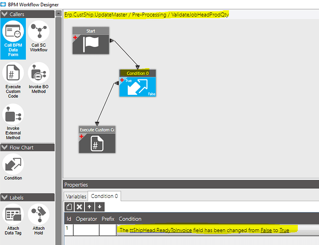

hi
I figured it out :slight_smile: I added the condition widget and checked to see if ReadytoInvoice was false then execute code.
Many thanks
