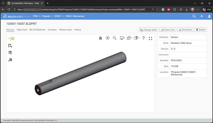

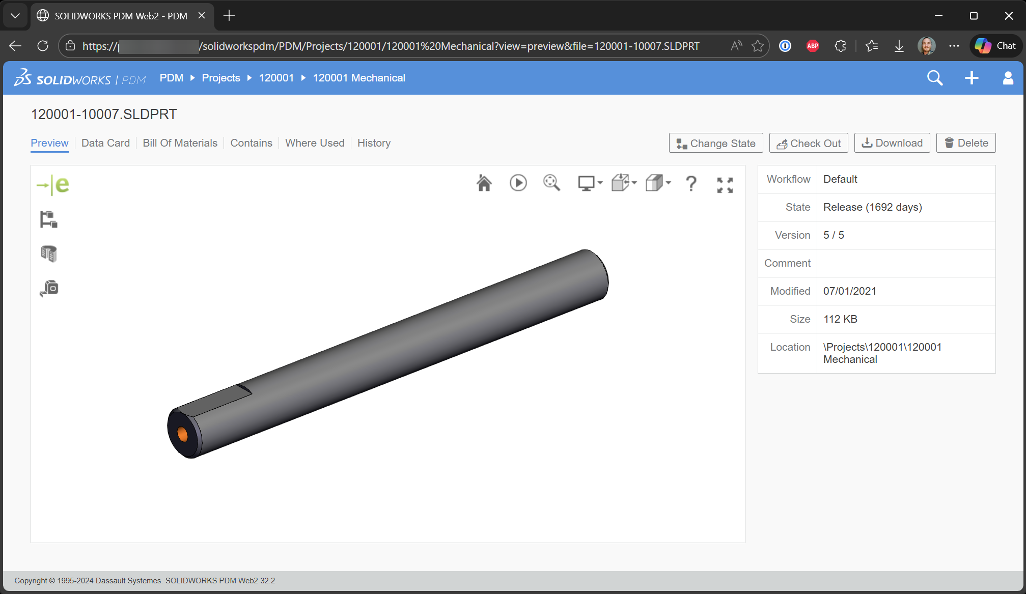

SolidWorks PDM has a web app that allows users to view files without the PDM software installed on their computer.
It has eDrawings embedded, so you can view models in 3D, measure, etc. Building the URL is pretty straighforward if you can get access to the document record in the PDM database.
We should try this again. The early versions of the web app were not that great. Looks like it has come a long way

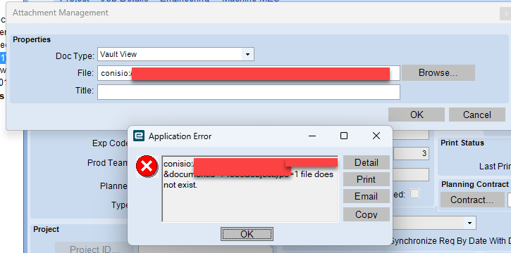

We have SolidWorks PDM at my current place, and we are trying to add these conisio links to jobs so people on the production floor can view job instructions that are located in the vault. The issue that we are having is that when we paste the links, it says that the file does not exist.
I tried a normal link for this document type (google.com) and I was able to open the link just fine. What did you do to make conisio links work in Epicor? We are currently on 2023.2 but will upgrade to 2025.2 soon if that changes anything.
The conisio protocol is not an actual file - you can’t create an attachment like this… If you store the documentId and projectId from PDM, you can create a customization to call the conisio protocol to launch your vault view.
Ah, I thought that the conisio link would work. My thought process was that it is a hyperlink that goes to the browser that then opens up PDM.
