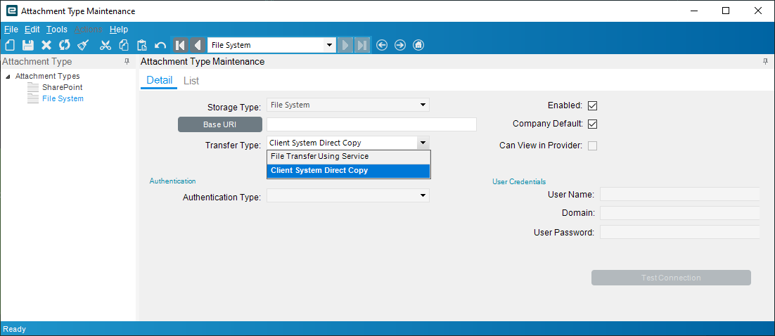

It only works with local-side file attachments, yes. But it should open them the same way as smart client does - download from share and open automatically.
I’m not following. Local, but from a share? What do we mean by local?
I mean transfer type - Client System Direct Copy - copy from local machine directly to file share without using service

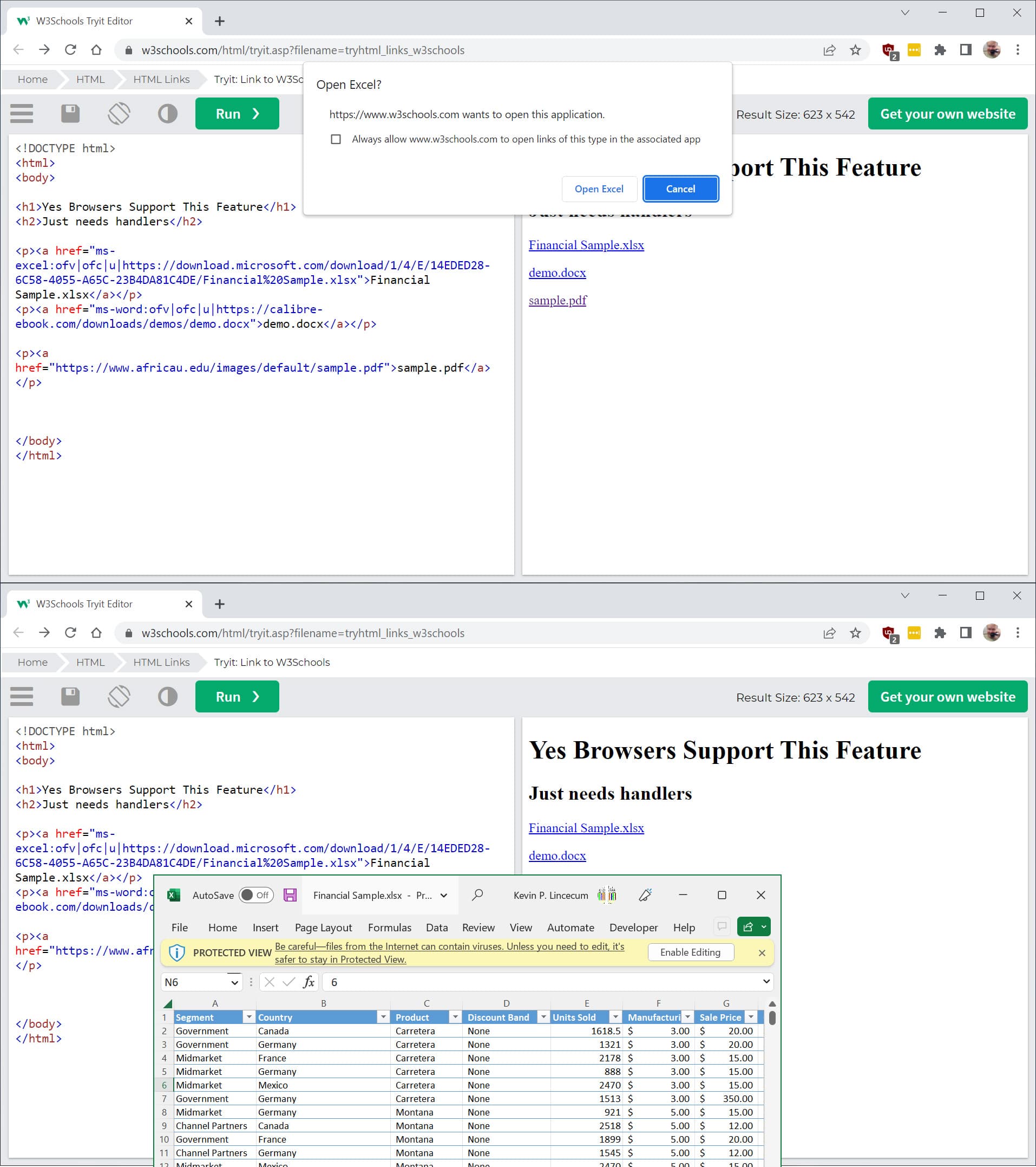

Depends on the file type and if a handler is registered.
Are you wanting to open documents INSIDE the Kinetic screens, or just have it download
and open up inside or outside the browser?
The second part certainly works fine, and many companies do that now.

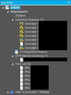

I am not sure if you have ECM or not. For people that do, we could just open up the tree on a screen and double click the attachment and it would open. Granted, this looks much easier because I already opened the tree. I may have had to do multiple clicks to get them all open, but once they are open like below you can just double click on each of them to open (you’ll see why I mention this later).

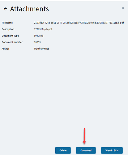

Once the next slideout opens, you need to click the download button.

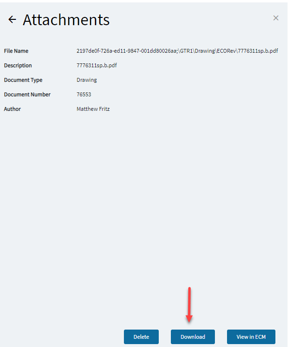

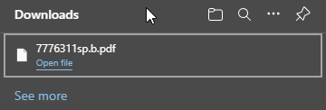

Then you need to open the file from the download and you will see your file.
Now, to look at the next file, you need to X out the last slide out. This gets you back to the list. Then you need to click the next document number of the file you want to view which opens back up the next slide out where you need to click the download button again. If you are trying to open up multiple documents, it takes a long time compared to before.

From what you’ve described, if I understand it correctly, it should be no problem to implement
on their end, as this is pretty standard functionality:
