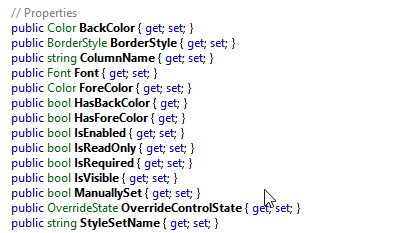

Basically, I wanted to highlight rows in an EpiUltraGrid with a colour that isn’t red, Green, Yellow or Grey. To do this, you need to create a ControlSetting and pass that to the last parameter of RowAction.

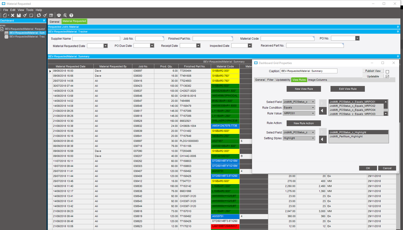

many thanks @AndrewM, any idea how i can add these code lines, so that new option will appear on dashboard view rules, or you suggest to do it differently?
It’s bypassing those settings, so it has to be done in code. That would be nice feature though.
so the code will do what this dashboard feature doing, so my question then do i need to hard-code my value within the class call?
@josecgomez posted a really good example of how to make it work here. I think this will answer your question.
And I notice that you have a run-time dashboard, you would need to deploy an assembly and make a customization to make this work.

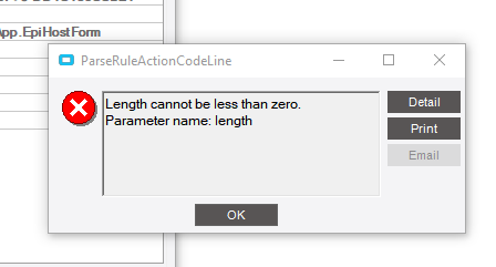

What’s the goofy warning that people are seeing? We’re on 10.2.200.11 and haven’t seen anything odd. Could the difference be that I made the change to a custom control?
When I open the customization (not the customized form, the actual customization editor) this pops up. One for every row rule that I modified. So I have 6 pop up for me. Otherwise it works just fine.
Here’s the code for mine, as far as I can tell, it’s the same exact as yours except for my names are a lot longer because I ended was modifying the wizard generated code. Maybe that’s what the problem is? If I didn’t use the wizard, maybe this error wouldn’t show up?

That looks mighty similar to me. Have you tried selecting ‘All Code (Read Only)’ in the script editor in case some automatically added code is messed up? That being said, it seems more like an editor bug than the custom code.
If you just remove the code for the conditional formatting, does the error go away?

A little, but I can’t change it so I didn’t dig in that hard.
I’m not using an adapter because the grid is populated with a grid already native to the dashboard. It could be the difference??
Could be. My thinking was that the data view hasn’t been initialized when the custom code is being called. The other thing is that I created my by first adding the standard row rule (just select Error) and then modified that. It could be a hidden table parameter that is being changed. Have you checked what happens if you just add a standard row rule to see if you still get the error?
I’m sure that @josecgomez would know. He’ll probably read this thread at some point and laugh at us.
The weird things is, the error only comes up when opening the customization editor. In normal use it works fine. That’s why I haven’t dug into it too hard. It pretty much just annoying to me , since I’m the only one that sees the errors.
And yes. Standard row rules work just fine.
Yeah… I’m just too curious when things like this happen.
There have been a few bugs in the customization editor that I’ve run into in the past (one which would somehow copy all the uneditable code to standard code if you saved while showing all code), but they seem to be fixed in our current version, so wouldn’t surprise me if there is an editor bug.
