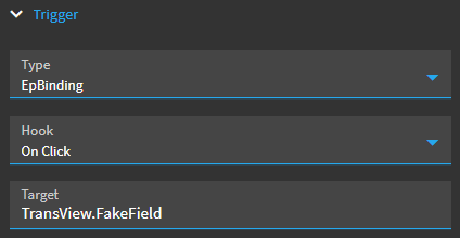

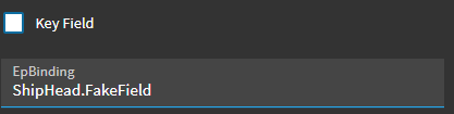

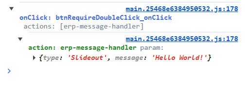

We’ve seen several different repeatable examples of this issue. In all of the cases we encountered, the button had an EpBinding on one of the standard Data Views, the button and the click event was using an EpBinding trigger, Hook ‘On Click’, and Target set to the field on the button’s EpBinding like this:

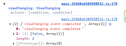

It seems that under some conditions when the click event is triggered by type EpBinding, with Hook ‘On Click’, the current Data View needs to be set to the same Data View the button is bound to before it can be clicked. This is why you have to click it twice. You will notice that under this circumstance, if you look in the console with debug mode on, the only thing that happens on the first click is the current Data View gets changed to the one the button is bound to. Then the click event triggers on the second click.
First Click:
Second Click:
When we’ve encountered this, we have been able to resolve it three different ways:

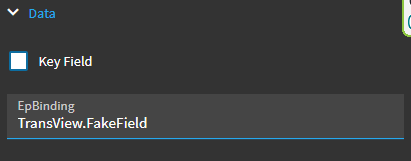

Changing the EpBinding and Event to use a TransView EpBinding like this:

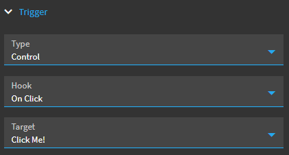

Changing the trigger to be a Control type trigger like this:

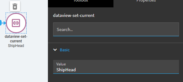

Setting the current Data View to the Data View the button is bound to before the click (works if it is happening under very specific circumstances where you have the ability to set the Data View in an event) like this:
