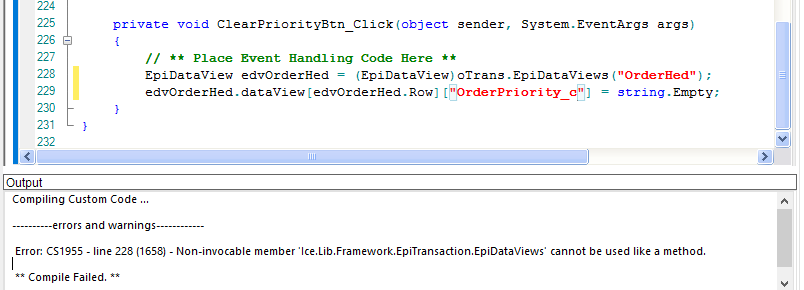

I don’t actually know how to use the resulting information in the Button Click Event code (very new to this). Can anyone guide me toward the solution? Is there a better strategy to accomplish this epiCombo reset from the form interface?
I already tried using the following post to try coding the button: Clear EpiComboBox - #2 by tkoch
It’s obvious that I put it in the wrong place or used it in the wrong context because I got the following error:
Error: CS1955 - line 228 (1658) - Non-invocable member Ice.Lib.Framework.EpiTransaction.EpiDataViews’ cannot be used like a method.
put your view in square brackets instead of the parenthesis.
Like this:
EpiDataView edvOrderHed = (EpiDataView)oTrans.EpiDataViews[“OrderHed”];

Thank you!
I actually ended up Commenting out that first line because I noticed the view was already called upon in InitializeCustomCode, but I also did notice the brackets/parentheses discrepancy after posting.
It’s working now. Thanks again!
