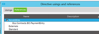

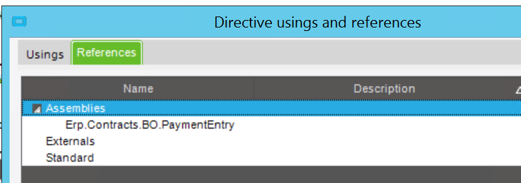

I am trying to create check headers for AP payments inside a UBAQ using a custom code BPM. It’s not attached to a table, I just have calculated fields for the user to dump data into and then have the checks created. I have read all the posts and watched a very helpful video and have gotten rid of most errors. I have 2 I can’t figure out.
var newCheck = ttResults;
foreach(var check in newCheck)
string myCompany = check.Calculated_Company;
int myCheckNum = check.Calculated_Check;
var existingCheck = (from ch in Db.CheckHed where ch.Company == myCompany && ch.CheckNum == myCheckNum select ch).FirstorDefault();
if (existingCheck == null)
using(var checkSvc = Ice.Assemblies.ServiceRenderer.GetService<Erp.Contracts.PaymentEntrySvcContract>(this.Db))
//Trace: <businessObject>Erp.Proxy.BO.PaymentEntryImpl</businessObject>
Erp.Tablesets.PaymentEntryTableset checkData = new Erp.Tableset.PaymentEntryTableset();
checkSvc.CreateNewCheckHed(check.Calculated_Group, ref checkData);
bool requiredBoolParam = false;
checkSvc.PostAllowed(check.Calculated_Group, out requiredBoolParam);
// from Data Trace- not sure where it's pulling False from
//<parameter name="allowed" type="System.Boolean"><![CDATA[False]]></parameter>
checkSvc.GetElecInterface(check.Calculated_Group, out requiredBoolParam);
checkData.CheckHed[0].VendorID = check.Calculated_VendorID;
checkSvc.OnChangeVendor(check.Calculated_Group, ref checkData);
checkSvc.OnChangeCheckNum(check.Calculated_Check, ref checkData);
checkSvc.OnChangeCheckDate(check.Calculated_Date, ref checkData);
checkSvc.PreUpdate(ref checkData, out requiredBoolParam);
//<parameter name="requiresUserInput" type="System.Boolean"><![CDATA[False]]></parameter>
checkSvc.Update(ref checkData);
#1: ‘IQueryable’ does not contain a definition for ‘FirstorDefault’ and no extension method ‘FirstorDefault’ accepting a first argument of type ‘IQueryable’ could be found (are you missing a using directive or an assembly reference?)
#2: The type or namespace name ‘Tableset’ does not exist in the namespace ‘Erp’ (are you missing an assembly reference?)
