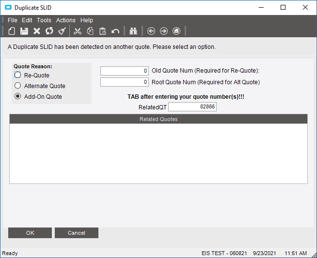

The challenge here is by default the form doesn’t have access to the quote data. So I passed the quotenum via BPMData “Number20” field. It displays on the BPM form now. So I’m trying to use that as the value to run the BAQ to populate the grid. We have a UD field “SLID” that links quotes as related to the same project. The ask is to display all quotes with the same SLID when creating a new related quote.
I’m trying to piggyback on some existing custom code that retrieves the BPM data variables.
As you can see, I got the quotenum to display that I want to use to populate the grid but no joy on getting the grid to work. Pretty sure I’m messing up in the EpiViewNotifcation section of code.

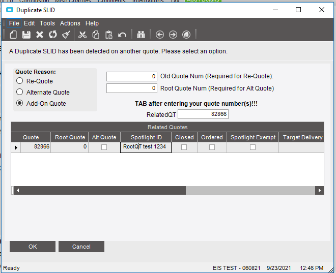

Ok got it working with some mojo from @hmwillett
Basically, it’s a trick. The form needed to be refresh to display the grid data. So to trigger the refresh the trick was to bind the BAQ View to another data column not passed by the BPM code. Without the bound field changing the oTrans.NotifyAll() wasn’t firing as there was no change to the data.
